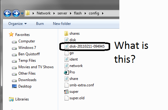

Also, any idea what this is? It was added to my flash drive 7 days ago (the day I added these 3 hard drives).
Can I delete either of these? It seems like they are the same file, but one fails to include my new disks (17-19). Is this something to do with them being 4k alligned?
That file in your image means you probably ran "New Slots" at some point (available in "Utils")
