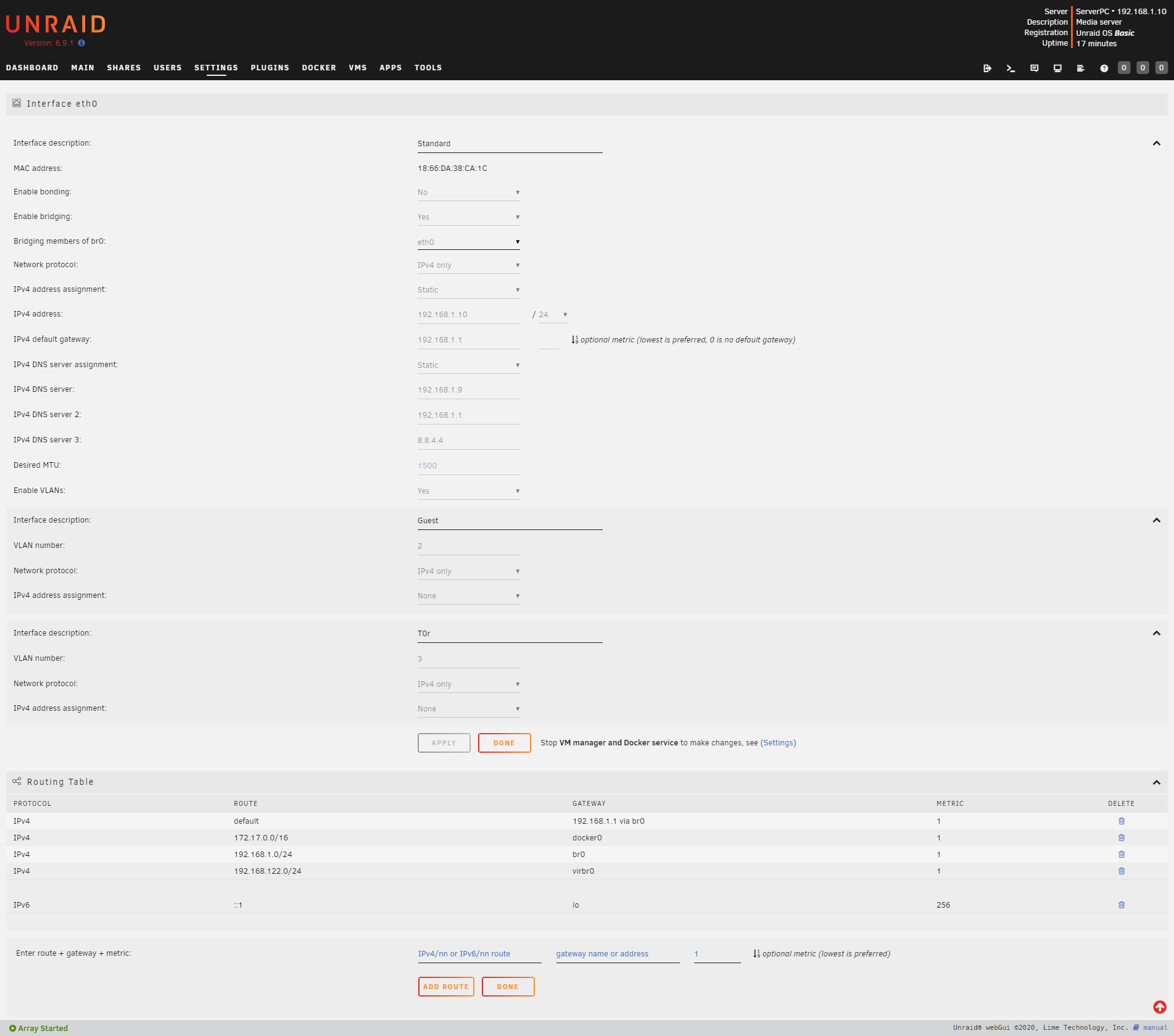

Hi everyone,
I already asked in the support thread for the Wake on Lan for VMs Plugin but received no help, hoping to get some help here.
After enabling VLANs on the unraid machine and enabling trunk on the switchport, Wake on LAN for the VMs does not work anymore. The VMs still are on br0 and default / native VLAN ID is 1. WoL package both sent from Guacamole Docker but also sent from a Client in VLAN 1 network (192.168.1.0/24) do not wake any machine up. Usual network works as expected.
Any ideas?

unraid Network Settings:
Spoiler
