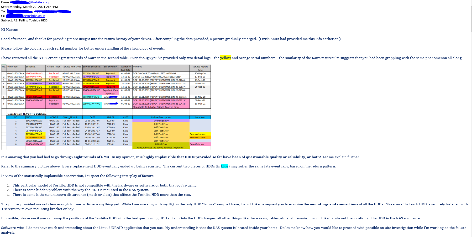

  1. Toshiba N300 Drives kept having seek error rates at random intervals(RMA 2 drives 8 times)

1. Toshiba N300 Drives (May not be related but just checking if any other toshiba users seem to be having the same issue
So I got 2x Toshiba 6TB N300 drives which I brought over from my Synology in good health prior to switching to unRAID, however the drives kept throwing out 'seek error rate - 'in the past' and 'FAILING NOW' after a few days to weeks of usage and these kept giving really loud sounds from the drives. and I even had some which was only used for less than 24 hrs and they started throwing out the same smart error again.
The HDDs are all properly mounted in my Fractal R6 casing with the rubber grommets to the tray.
Got so pissed after having gone down to RMA these 2 drives at least >8 times that I got into contact with Toshiba and they have said it's a 'phenomenon'. Just kinda worried that as I kept replacing the drives, I have to do a parity-sync every single time which puts unnecessary stress on all my drives, am finally done with these Toshiba drives and also redid my config a little by removing one a few days back and in the process of pre-clearing a new 12tb WD Elements which I'm about to shuck to replace the other Toshiba drive.

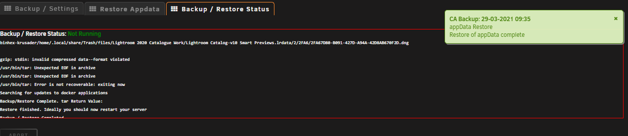

So finally the parity was rebuilt and this morning I woke up hoping for a reply here but nothing and my drowsy ass wanted to get plex back up working as I share with quite a number of family and friends and some have been asking me constantly the past few days. Remembering I did the Backup/Restore just as I was typing the post above late last night.
So my drowsy ass stopped the array and then restarted it, however both the cache drive were suddenly unmountable, I thought heck, I got a backup done last night and shouldn't be too worried, so stopped the array and tried only putting cache 2 as the only cache drive but it didn't allow to mount, then I decided to do something stupid, which was to change the cache drives position. This was where the whole thing went wrong.
So as soon as I start array, they started formatting and once it was done I went to backup/restore to restore the app data and this was what I got, but the notification I got was green thinking that it was successfully restored.
Now I just checked my plex and I got no contents available. went to the appdata folder and only a few containers were there. However the important ones like bitwardenrs and nextcloud along with mariadb were all gone. On closer inspection I realize that something was invalid compressed data format as shown above. I then checked the backups folder and realized the compressed files was only 40gb, however it was 130+gb previously. and now it's only 11gb.
Is there any way I can recover all these things? Really any help will be appreciated at this point.
This is quite common with these drives, possibly a firmware issue.

Didn't know that Toshiba drives were incompatible with unRAID, at least that's good to know and will remove both drives from my system. Thank you for confirming this, guess  I'll update Toshiba's side.
They aren't, it's problem with the disks, it happens with any OS, many similar report with FreeNAS for example.

They are usually fine, I have several myself, but there's an unusually high number of SMART "seek rate error" failing now reported errors, but like mentioned it's not limited to Unraid, possibly a firmware issue, since most times the raw value returns to normal after a power cycle.
Noted on the drives, maybe it might be a specific drive model as they had mentioned and only issues w the newer drives models was running them in my synology and never had an issue w the older drives except for the noise from the disk as it's 7200rpm.

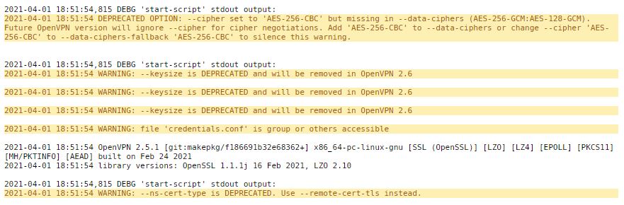

Anyway now it seems that DelugeVPN WebUI isn't accessible when VPN is turned on and can only be accessed when VPN is being turned off, however seems to be downloading when VPN is on as well but a ton of torrents are being requested at the same time. Any idea how I could fix this?
Best to use the existing docker support thread:
Hi again, have managed to solve the previous issue w a full fresh install of deluge and the system has been running fine until last night.

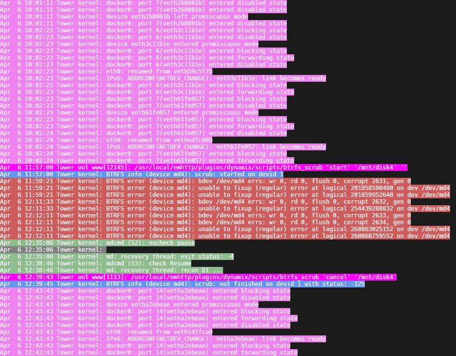

I started getting another BTRFS Error and my docker port keeps entering blocking and forwarding state.
I'm facing another issue as I'm trying to re-install the cache drive which I was trying to recover the appdata from. However when I assign 2 drives to the cache, I only get the notification that I need to format both the cache drive. Since my last mistake, I did not format due to the fear of resetting everything up everything again. So I've removed the 2nd drive and formatted it via UD, have not added back into the array as of yet as I replaced my last toshiba N300 with a new shucked drive last night Is this normal or is something corrupted? I've also ran CA Backup / Restore and verified tar value 0 (assuming 0 errors from what I researched) and have changed the appdata share from 'prefer' to 'yes'
Also Toshiba side has recognized that the N300 has some issues w running unRAID and has offered me to change to their MG (enterprise) series drives, however I would require a small topup with a brand new 5 years warranty, Is this a good idea?
Anyway here's the latest diagnostics, thanks so much for any help! Love this community.

Btrfs errors are from disk4, data corruption detected, this is likely caused by a hardware problem.
As for the cache, formatting one of the devices is not a good idea, but post new diags after a reboot, with the array started.

These errors only show up when I try scrubbing disk 4, however it still can't seem to be fixed, should I use unBALANCE to move all files off this drive and reformat it? Will it help solve the isssue or will the corrupted file just move over to another disk as I can't seem to locate the corrupted data on disk 4.
Apr 7 13:13:43 Tower ool www[6597]: /usr/local/emhttp/plugins/dynamix/scripts/btrfs_scrub 'start' '/mnt/disk4' ''
Apr 7 13:13:43 Tower kernel: BTRFS info (device md4): scrub: started on devid 1
Apr 7 13:14:22 Tower move: error: move, 391: No such file or directory (2): lstat: /mnt/cache/appdata/binhex-plexpass/Plex Media Server/plexmediaserver.pid
Apr 7 13:15:44 Tower kernel: BTRFS error (device md4): bdev /dev/md4 errs: wr 0, rd 0, flush 0, corrupt 2637, gen 0
Apr 7 13:15:44 Tower kernel: BTRFS error (device md4): unable to fixup (regular) error at logical 201858580480 on dev /dev/md4
Apr 7 13:15:44 Tower kernel: BTRFS error (device md4): bdev /dev/md4 errs: wr 0, rd 0, flush 0, corrupt 2638, gen 0
Apr 7 13:15:44 Tower kernel: BTRFS error (device md4): unable to fixup (regular) error at logical 201859952640 on dev /dev/md4
Apr 7 13:25:53 Tower kernel: BTRFS error (device md4): bdev /dev/md4 errs: wr 0, rd 0, flush 0, corrupt 2639, gen 0
Apr 7 13:25:53 Tower kernel: BTRFS error (device md4): unable to fixup (regular) error at logical 254439288832 on dev /dev/md4
Apr 7 13:26:26 Tower kernel: BTRFS error (device md4): bdev /dev/md4 errs: wr 0, rd 0, flush 0, corrupt 2640, gen 0
Apr 7 13:26:26 Tower kernel: BTRFS error (device md4): unable to fixup (regular) error at logical 260863025152 on dev /dev/md4
Apr 7 13:26:26 Tower kernel: BTRFS error (device md4): bdev /dev/md4 errs: wr 0, rd 0, flush 0, corrupt 2641, gen 0
Apr 7 13:26:26 Tower kernel: BTRFS error (device md4): unable to fixup (regular) error at logical 260868759552 on dev /dev/md4
Edited by jvlarc
Corrupt files can't be moved by the mover, you should delete them or restore from backup.
Sorry but do you know where I can locate the corrupted files? I'm having issues with finding these 5 corrupted files
