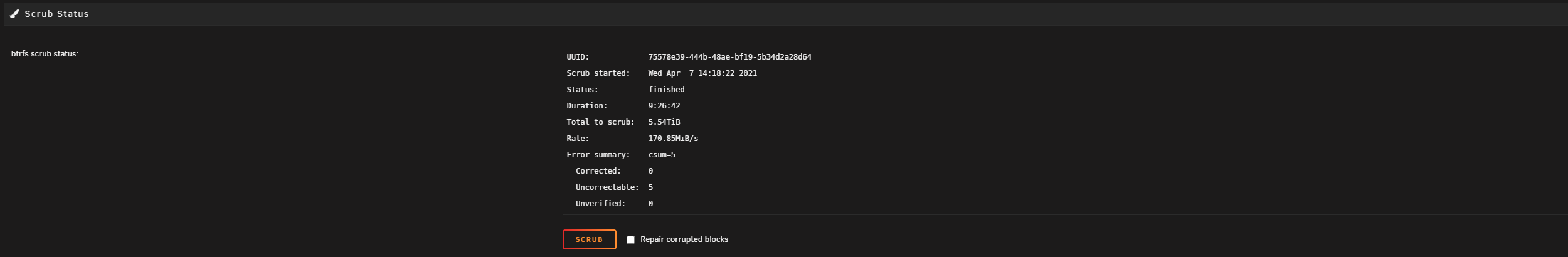

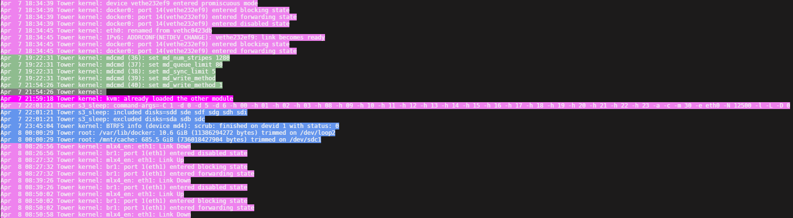

So I did run a scrub on disk4 yesterday after my parity finished syncing w the new drive and it completed last night, syslog showed that scrub finished on devid 1 with status:0,  does this mean 0 errors? however when I check back under scrub status it still shows uncorrectable: 5. I do not have a complete backup of this disk thus I do not know what I should be restoring and how I should go about restoring or deleting
Also I'm still having issues with my ports entering blocking and forwarding state ever so often which takes awhile for me to access unraid through my network shares. For my 10gbe connection as well I still cannot ping through command prompt on my main pc with the other 10gbe card.

Errors during scrub don't point to any files, which is strange, but from my googling it appears that when that happens the blocks are from orphaned data, so you should be able to copy everything from that disk.
Yeah that's the part I was pretty confused about as it should show up as what you had previously mentioned and I managed to get rid of the 500+ corrupted files, thank God it's all linux ISOs anyway (I do have off-site backup for my important data), so far no issues playing back videos like before. So basically these orphan data would not affect my other data in anyway or should I scatter the data to other disk and then reformat this drive? Would that work better?
Should not affect, but IMHO it would be better to backup and re-format the disk to get rid of those errors.
