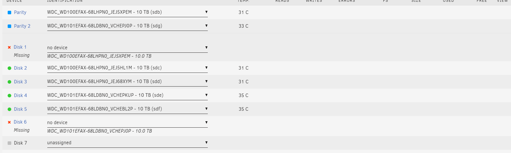

Thanks for this advice - I did identify my Parity devices - Now I am in the state, that all disks are assigned.
If I change my parity disks (in the below sections) to no device and put them into the parity section.
The answer is: "To many wrong and/or missing disks" (see error1.png)

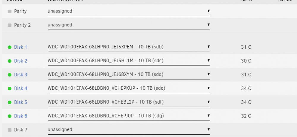

so doing a "Tools->New Config" (new-config.png) - I think I will not presserve anything - so None
I seems, that the new-config will not work.

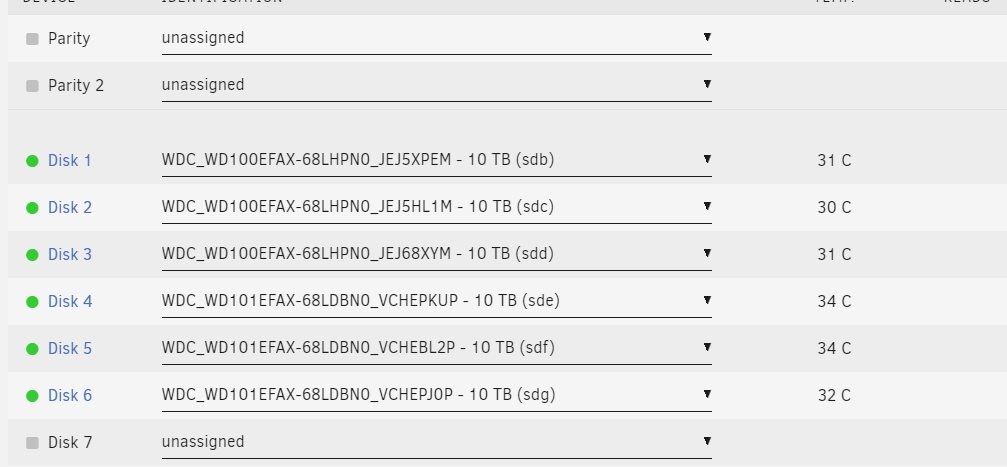

Also after an reboot (see after-reboot)
Thank you very much for your help.
Tools -> New Config WILL work. From your screen shot you seem to not have set the slots that had parity drives to "unassigned" (and possibly shuffled up the data drives)?
I prefer to use the option to preserve current assignments as it means you have less changes to make when you return to the Main tab to correct any drive assignments to their final settings to there is less chance of making an error.   It puts the array back into a state where no drives are yet committed to the array and you can make changes before starting the array to commit the changes.  At this point you want to unassign the parity drive(s) from being a data drive and assign the it to the parity slot.
Now when you start the array parity is rebuilt based on the current assignments.
It is important that you do not assign a data drive to a parity slot as that would result in its contents being lost as they get overwritten with parity information.
