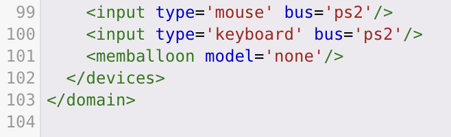

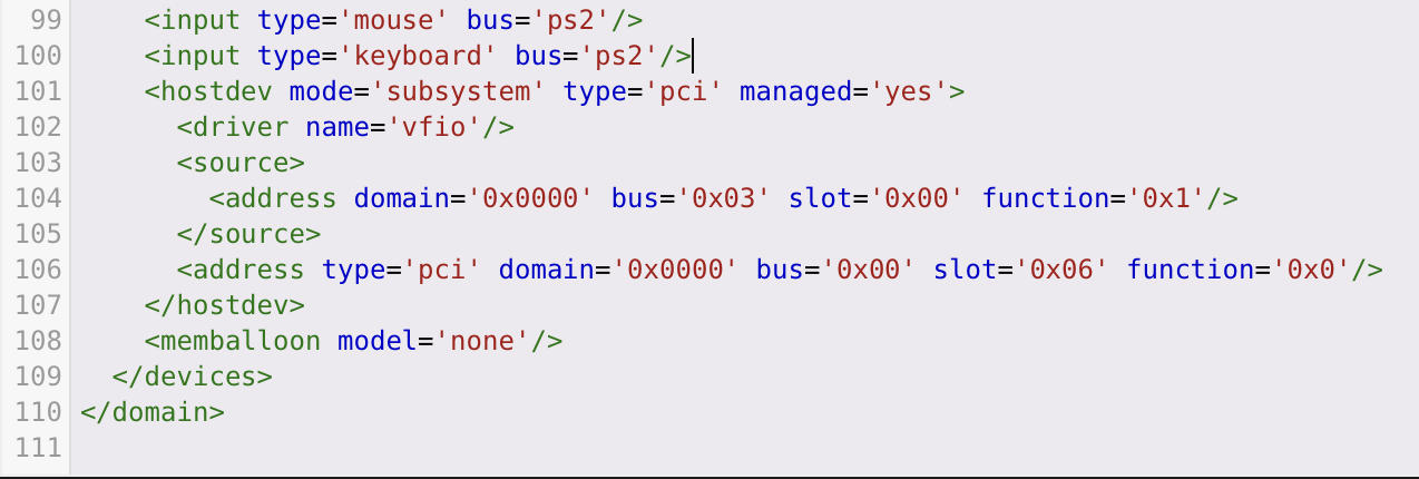

  13. Double check there are no hostdev tags, if there are, delete them because your other server is very unlikely to be using the same device IDs / PCI addresses.
    Eg.
    670066374_ScreenShot2021-03-29at10_12_55pm.thumb.png.06572183e7060dc26564096e966c6ab3.png
    Would become:
