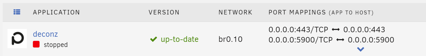

eg. looking at this container (I know it is stopped) shows the port mappings

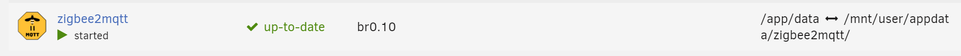

however this container doesn't show anything even though I do have port mappings defined (it is showing the volume mappings though)

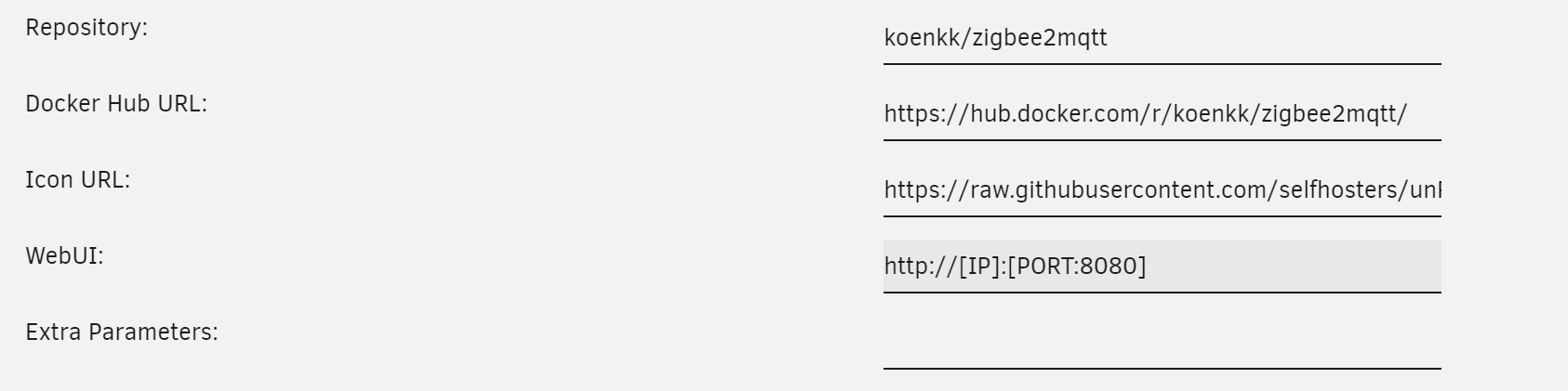

I have also attempted to add the missing Web UI for this container but whilst it is showing and included in the user template
/boot/config/plugins/dockerMan/templates-user
it doesn't show up as an option.   I have recreated the container from the template and restarted docker but this doesn't seem to stick.   Neither the port mapping nor the web UI menu item show up.

Because it's on a separate bridge and because the dockerfile the author created doesn't expose any ports.  Nothing to worry about

What about the Web UI though, that has to be unraid specific and I have updated the template to include a web UI address but this doesn't appear in the menu for the container.

Correct.  Anything you add still works, but if the dockerfile doesn't reference them you won't see them.  Basically lazy authors.
The WebUI thing is also related, (but only when running on a custom bridge)
