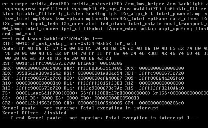

I'm having a persistent issue with kernel panics on Unraid, and I'm trying to troubleshoot my way out of this, but it's not working so I'm turning to you guys.
At best, I get about 3 days of uptime before it hits. I've tried a ton of things suggested on this forum and reddit.
I'm not ruling out a hardware problem, since the server (Supermicro X8DT3-LN4F, 2x Xeon X5650, 48GB RAM) was bought used on Ebay, but video card and SAS controller are new. Memtest comes up clean. Hard drives are a mix of new and ones I used in my Synology for a bit, but all test clean.
I had some issues with UDMA CRC SMART errors when I first setup Unraid, but figured out it was the onboard SATA ports being flaky, which is why I switched to the SAS controller.
I'm about halfway through my trial, and I really want to get this working because I love what Unraid offers, but it's getting to be sink-or-swim time to decide if I stick with the platform or cut my loses and move to something else.
I can't pinpoint what's causing it, so any suggestions would be appreciated.
640520941_2021-04-0109_05_33-IPMIView2_18.0(build201007)-SuperMicroComputerInc..jpg.2d66f3836d40e280c98dd431cdd3fc31.jpg
unraid-diagnostics-20210401-0911.zip

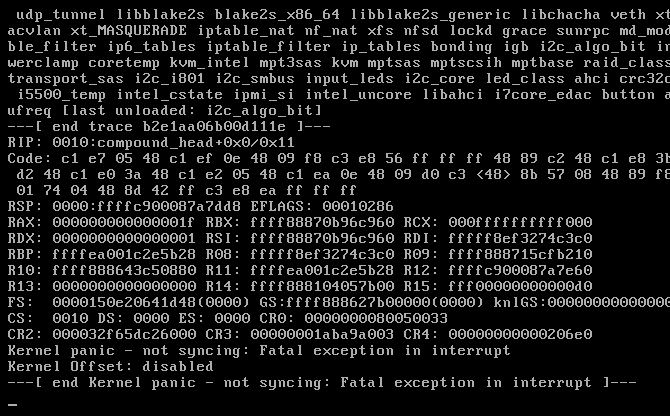

Another one last night. I attached the syslog.
1604989858_2021-04-0208_38_48-IPMIView2_18.0(build201007)-SuperMicroComputerInc..jpg.e7d5304e3775b717f51b3268d7e9af79.jpg
syslog

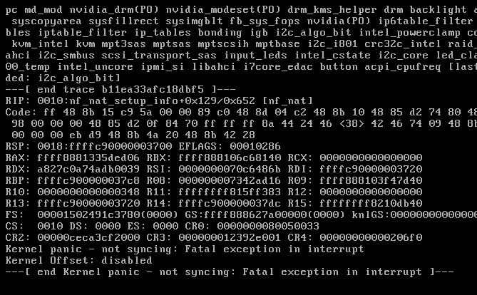

Still crashing, even after removing the Nvidia drivers.
879859024_2021-04-0410_48_51-IPMIView2_18.0(build201007)-SuperMicroComputerInc..jpg.6219c2a86ffeb2631a07621bdb12a210.jpg
syslog
Are you running any containers with their own IP address? I see macvlan mentioned, and that is a known issue with some setups.
Also, blake2 is shown, are you by any chance using the file integrity plugin?
2 hours ago, Diesel said:
Still crashing
As mentioned by @jonathanm you have lots of macvlan broadcast call traces in your syslog.  These will eventually crash the server.
If you have IP addresses assigned to docker containers on br0/br1 see this thread for some possible solutions.
I have 3 containers using br0 due to port overlap with other containers. Looking at the thread that @Hoopster mentioned, it looks like setting up a vlan for the containers might be needed to resolve this.
Curious though... it this functionality considered broken? I thought the whole point of using br0 was for this use case.

IP addresses on br0 work great on many systems with no call traces.  The problem only arises with certain hardware setups.  Some have it, some don't and so far there has been no common denominator identified.
If you have the problem, VLANs seem to be the solution that works for most.
Follow-up: I setup a VLAN for the containers this morning, set the containers to use the new interface, and I'm currently hammering the box via Tdarr, which previously seemed to exacerbate whatever was causing the kernel panics.
So, fingers crossed that resolved it. Wait and see...

Looks like it crashed again. Hard locked this time. I couldn't even get the local console or IPMI KVM to wake up to see what happened.
Checked the syslog, and it looks like there's still some macvlan issues going on. I had it down to 2 containers on the vlan, and still...

Mainly posting for posterity now, in case this ends up helping someone with the same problem in the future.
I've replaced some of the containers (ie. torrent client) on the VLAN with different apps that don't use the same ports, so no overlap with others and they can live on the bridge network.
The remaining containers that were on the vlan have been turned off to see if that stops the crashes.
I saw another post that mentioned, in addition to putting br0 containers on their own vlan, also turning off "host access to custom networks", which I needed to enable to allow my apps on the bridge network to talk to those with custom IPs. So, that's on the troubleshooting checklist as well. For now, I'll just leave the VLAN hosts turned off.
If I can at least get this box to stay up successfully without crashes, I can live with a workaround, as frustrating as that may be. Then I can tweak things with additional suggested fixes if needed. But I'd at least like to make it to the end of the trial without another crash, if possible.
Edited by Diesel
Just as a further follow-up, everything has been working smoothly on the kernel panic front since taking the containers off of the br0 interface.
I haven't had a chance to test it again running a container on another VLAN since turning off "host access to custom networks", but I may still get to that at some point. For now, I'm managing without that particular container.
I've also upgraded to 6.9.2, as @bonienl mentioned. I'll retest that as well as soon as I'm able.
