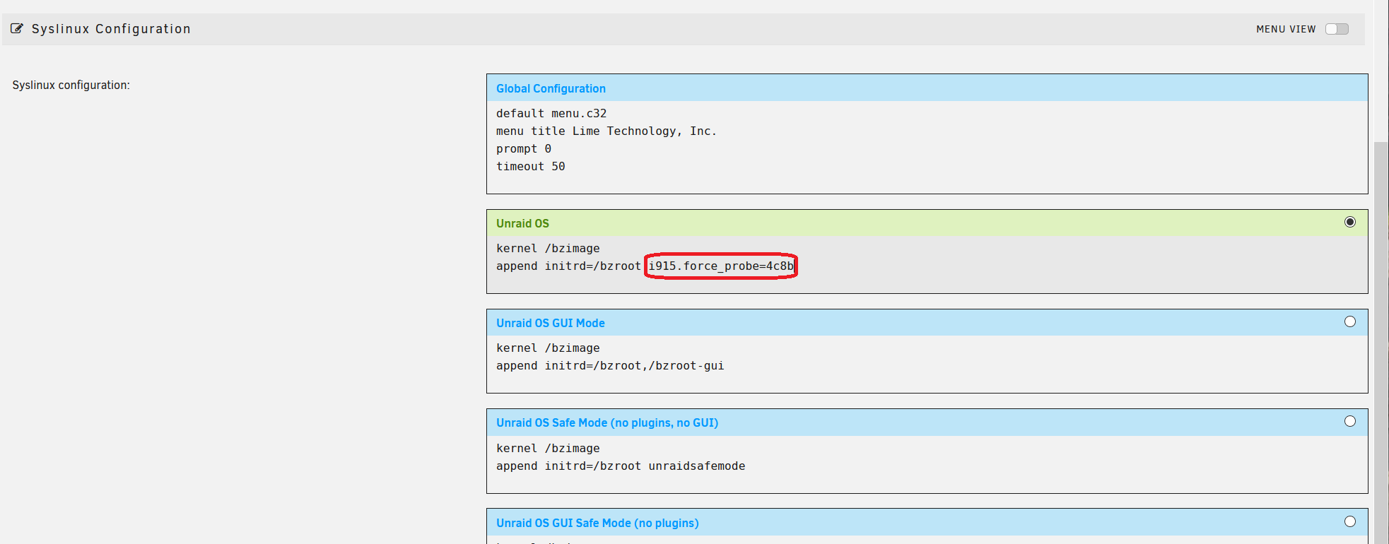

  • Please try to append 'force_probe=4c8a' to your syslinux.config and reboot (if you do it like that then please remove the contents of the i915.conf file). Please don't double post, you also can m
  • You can also add this as said to your syslinux.conf file so that you don't have to do anything or create a file if you installed the Intel-GPU-TOP plugin. But I was wrong above you have to do it

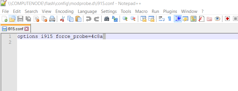

Have you tried adding
options i915 force_probe=4c8a to file /boot/config/modprobe.d/i915.conf and rebooting?
46 minutes ago, xXx said:
Just to confirm you have the following
root@computenode:~# cat /boot/config/modprobe.d/i915.conf
root@computenode:~#
I dont have a new gen cpu, but dont get any errors.
root@computenode:~# modprobe -c | grep 4c8a
Please don't double post, you also can mention me here. ;)
Your i915.conf file has to be empty or at least have only the middle line in it, the first and the last line are wrong.
30 minutes ago, ich777 said:
Intente agregar 'force_probe = 4c8a' a su syslinux.config y reinicie (si lo hace así, elimine el contenido del archivo i915.conf).
Por favor, no publiques dos veces, también puedes mencionarme aquí. ;)
Su archivo i915.conf debe estar vacío o al menos tener solo la línea media, la primera y la última línea son incorrectas.

1 hour ago, xXx said:
force_probe = 4c8b
But I was wrong above you have to do it in this format:
i915.force_probe=4c8b
Simply append this to your syslinux.conf file and this is appended when the Intel-GPU-TOP plugin loads the drivers, so no need to create the file with the contents (Main -> Click on 'Flash' and append it like that and click Apply at the bottom):

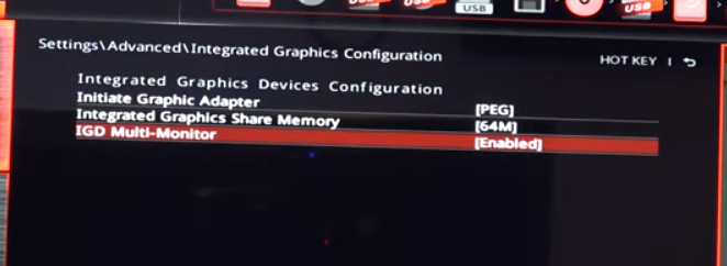

I think on my motherboard, I had to set to iGPU other wise uses the pGPU(PEG). So you may need to check BIOS.
root@computenode:~# lspci  | grep VGA
00:02.0 VGA compatible controller: Intel Corporation Device 9ba8 (rev 03)
01:00.0 VGA compatible controller: NVIDIA Corporation GK106GL [Quadro K4000] (rev a1)
This is for a MSI taken from a youtube video, you will need to change Primary from PEG or enable IGD Multi. Not sure which Motherboard you have.
Edited by SimonF
