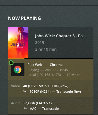

Hardware accelerated HDR Tonemapping is working as of Plex version: 1.23.0.4497.
1716193791_ScreenShot2021-05-09at12_59_39PM.thumb.png.0468ad9e7d07ebec5aafc5d500fb659c.png

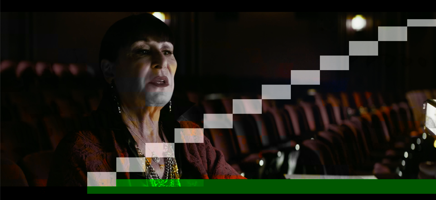

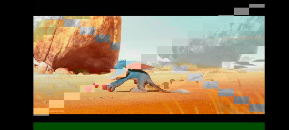

Weird graphics glitches still occur if using HDR Tonemapping below the 1080p HD High setting

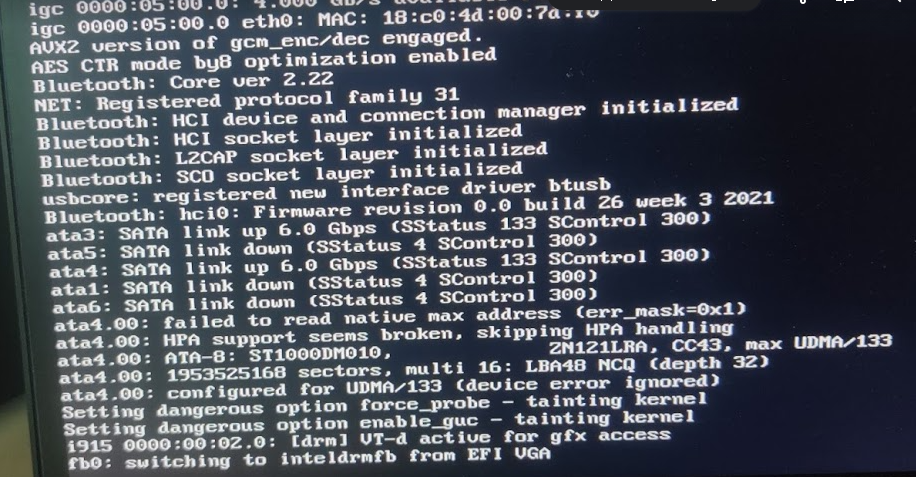

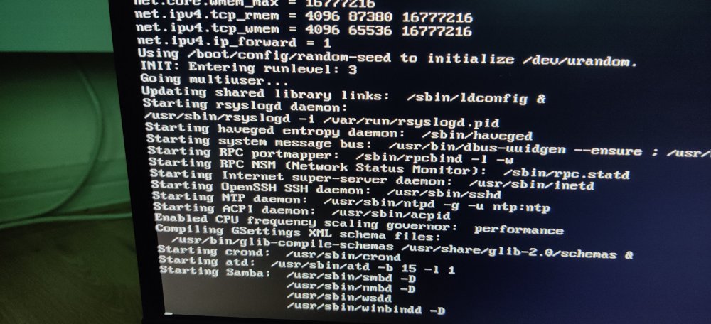

Hi i really need help. I'm using Intel i5-11500 and I've done as instructed but unraid will not boot and will get stuck at "switching to inteldrmfb from efi vga" and will just stuck there forever
Edited by fahmietalife
Update: i have to remove the thumbdrive and plug in to my laptop and manually remove i915.conf file, then i am able to boot to unraid.
Appreciate someone that can advise me as i really need hardware transcoding to work.

I've look in my BIOS option (im using Gigabyte H470I AORUS PRO AX), there's only option to disable/enable iGPU and it's currently enable
root@unraid01:~# modprobe -n i915
root@unraid01:~# modprobe -n i915 force_probe=4c8a
root@unraid01:~# /dev/dri
bash: /dev/dri: No such file or directory
-n is a dryrun so wont create any /dev/dri, but do you get any error output when you run the commands or syslog entries.
You can run without -n, but suggest you stop the array just in case you need to do a hard reset.
I'm not getting any error output when i ran the command, same goes in syslog.
Today i update to latest BIOS firmware version May 2021 from Gigabyte website, but still having the same issue.
