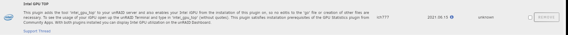

Install intel-gpu-top for 11th gen and you dont need to create file or syslinux.
Plugin will enable igpu for 11th gen.
You may need to remove file from /boot/config/modprobe.d

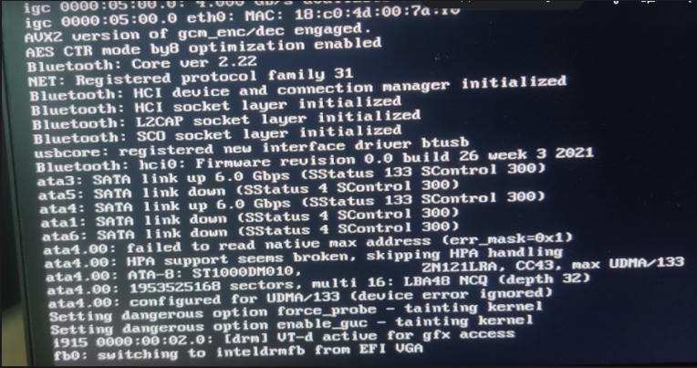

9 minutes ago, fahmietalife said:
I have to turn off my system, take out the USB boot drive and access it from my laptop and remove the i915.conf and i'm able to boot my unraid without issue (but still not getting hardware acceleration). Tested many times but still getting same issue.
Can you try to remove the i915 file, boot your server, install the Intel-GPU-TOP plugin and then reboot again and see if you are stuck with the same message or if it boots and if you can issue:
ls -la /dev/dri
from the terminal?
As said above I have another system with a 11500 and on this system it does work just fine.

Intel-GPU-Top is always installed and enabled until now. No issue to boot Unraid with it.
I also have no i915 file, as i mentioned i cant boot unraid with it so i had to remove it.

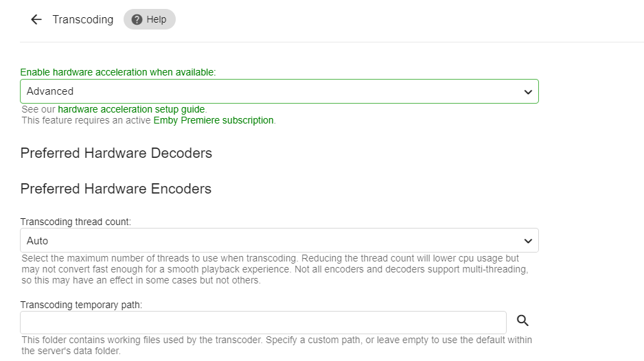

BRO NO USE TO MAKE IT WORK.
Can you please post a screenshot from your emby template?
That's really strange because I have now multiple reports that it works.
