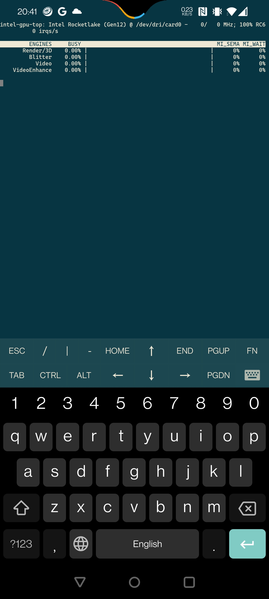

Hi all,
I recently upgraded to a 11400, I installed the Intel GPU Top plugin and is working from terminal however when I go to GPU Stats plugin, only my 1050 is listed.
Do I have to remove the 1050 for the iGPU to show up?

If you have an external gpu you may need to change bios settings to enable igpu.
I checked that, it's set to Enable on a Gigabyte mobo and the iGPU info shows up under the terminal command, just not seen in GPU stats, only 0: NIVIDA is listed
Have you install intel gpu top by ich777 has this installs a cmd required by the gpu stats plugin.

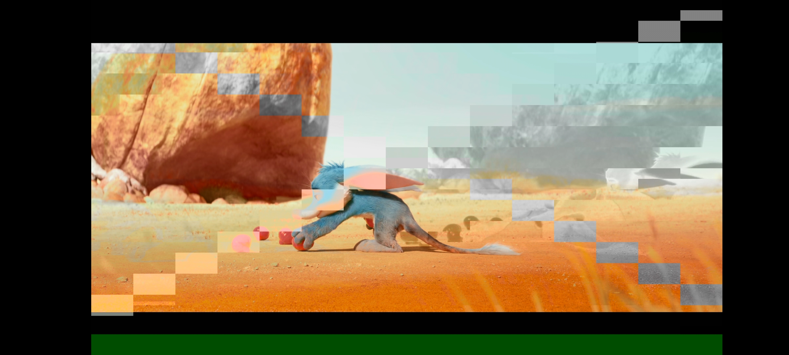

I'm setting up a new server with the 11600 CPU.
I get this log from the plex docker when trying to hardware convert with HDR to SDR tone mapping. The image also has corruptions (see attached image). Intel_gpu_top shows very high gpu usage. 70-80% Video, 30% Render.
beignet-opencl-icd: no supported GPU found, this is probably the wrong opencl-icd package for this hardware
(If you have multiple ICDs installed and OpenCL works, you can ignore this message)
I'm using Unraid 6.9.2.
I am NOT running any i915 file in /boot/config/modprobe.d or modification to the go file.
I only installed intel-gpu-top plugin and rebooted the server.
The plex docker image I am using is ghcr.io/linuxserver/plex
Using tag latest
My render location is /tmp
Hardware dev/dri passthrough to docker is on.
Any assistance regards clearing the transcode image corruptions and the open-cl error would be most appreciated.
Edit: I also tried setting an older static plex docker image as suggested in another post. plex:version-1.22.0.4163-d8c4875dd. Still the same result with HDR to SDR on
Edited by Presjar
This is a problem that was well discussed here and has nothing to do with your hardware or anything else and is a issue from Plex from what I know.
For testing purposes you can try my Jellyfin container from the CA App and see if you get the same artifacts (don't know if that also works with HDR but at least you can try):
This seems to all work well, UHD conversion to 1080p including the HW iGPU HDR to SDR works as expected.
I don't think the current plex containers are using the HW tone mapping (VPP) as my error in Plex refers to openCL not working. In Jellyfin the comment for "Enable VPP Tone mapping" is
Full hardware based tone mapping without using OpenCL filter. Currently works only when transcoding videos with embedded HDR10 metadata.
Edit: Head over to this plex support thread. Active support is happening.

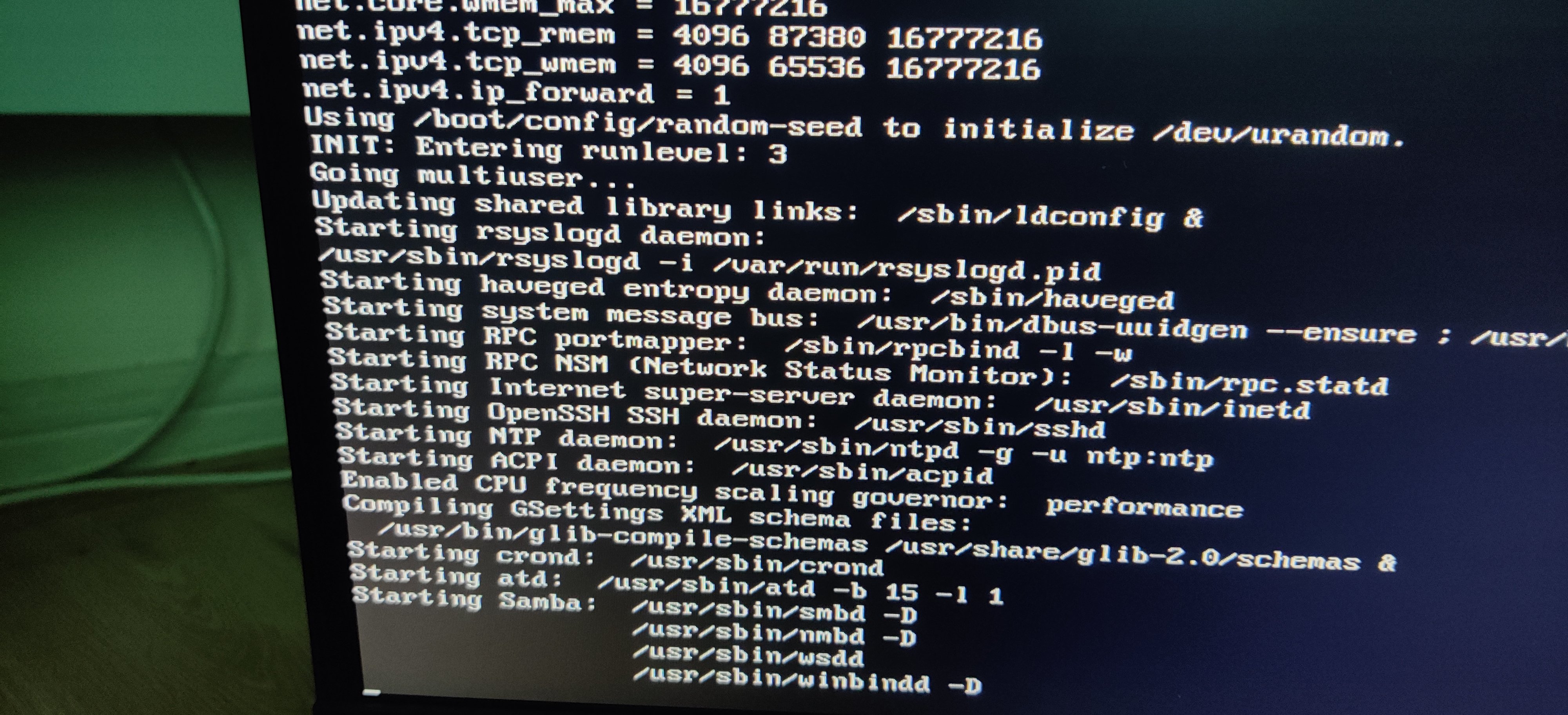

On 6/16/2021 at 3:37 PM, fahmietalife said:
Ok sounds like i have to reboot my Unraid when im back at home, im just worry that it will fail to boot, especially when im at the middle of the ocean. Anyway thank you sir, i'll update you when im back at home.
So im finally back at home last week and i rebooted my server but it failed to boot up. It got stuck at below. I had to remove the intel gpu top plugin manually from the thumbdrive then only i can boot to unraid.
Edited by fahmietalife
