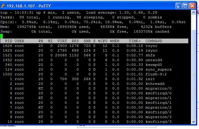

you are running out of memory constantly
which is crashing the server
can you tell us which add on's you are using ?
any process in TOP which is running high ?

i have been thinking about your case for some time now ... but i have no clue what is happening to your machine
i move constantly 8gb + files from my cache to my array
never have problems
my top is much more busy then yours...  when rsyncing he sometimes goes up to 7
only thing i can think off is that you are somehow moving stuff to your memory somehow and not to your disks
but i have no clue how that could happen...
