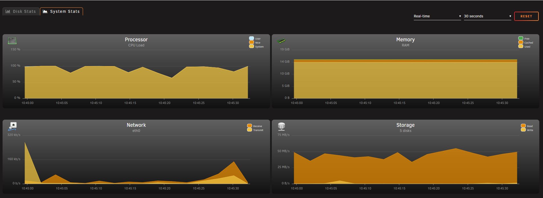

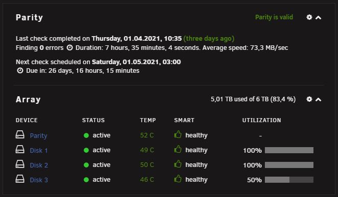

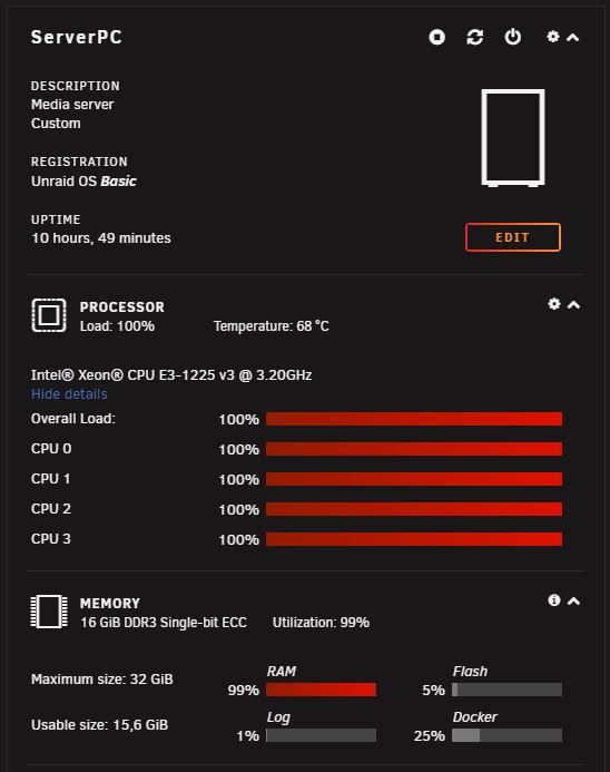

One of my Docker Container writes data to a share, wich is totally fine! But as soon as a drive reached 100%, all the docker containers stopped working. Also RAM and CPU went both to 100% and something begins to read disks.. See the Screenshots:
1759102809_CPURAM.JPG.333f9defc28730968d9dd631cbe25a3e.JPGArray.JPG.933a8c276d959be74a94d4bf77ddc9ae.JPG1843816894_SystemStats.thumb.JPG.9e3c7f3559aa3228ec78c2a9881e2022.JPG

Also I cannot open the Docker Tab on the unraid web UI nor open the Docker Settings under Settings Tab → Docker
It's like that for around 10 hours now, hoping it will fix itself, but no luck so far.

Whats a good way out of this situation? Stop and start the array? Reboot the Server? Still 100% RAM and CPU.

I was able to stop and start the array. Downloads are paused now, when I start it, it begins to write to disk 2, which is 500MB left. If I keep downloads running, RAM and CPU will fill up when disk 2 is full again, I'm very sure.

Why are you letting this happen?
Unraid has no way to know how large a file will become when it chooses a disk for it. If a disk has more than Minimum Free for the share, that disk can be chosen, and if it runs out of space it will fail.
You must set Minimum Free for each of your shares to larger than the largest file you expect to write for the share.
I was ignorant enough not to do that. Minimum free space is set now, I think I won't run into that issue again.
