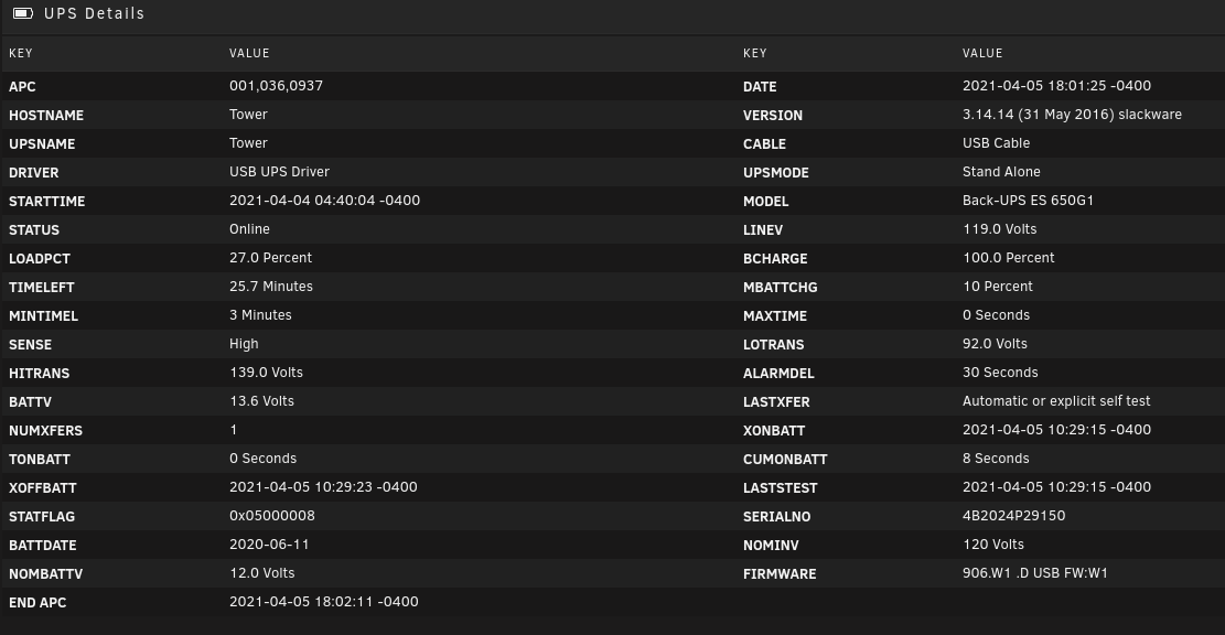

Found this in my log:
Apr 5 10:29:15 Tower apcupsd[31270]: UPS Self Test switch to battery.
Apr 5 10:29:23 Tower apcupsd[31270]: UPS Self Test completed: Not supported
Not sure if I am protected or not.
Any comments?
Thank you.

You are most likely still protected, however the "Back-UPS" units are usually more intended for small, lower power devices like your router or cordless phone.
While they can be connected to computers, the information they output over USB to the host is usually only "core" information about line conditions, battery voltage and estimated runtime.
I believe the error you're getting means that either the ACPUPS service, or the UPS itself attempted to perform a self test (I believe APC UPS's perform self tests every 2 weeks), but that your UPS doesnt support reporting on it.
It may be possible to perform one manually, however I would recommend stopping any Containers or VM's if you have them running and then stop the array (just in case) first, then try holding down the power button on the UPS for around 3 seconds. The power button should begin to flash and then go back to solid once the test is done.
You can also try just unplugging the UPS from the wall and see if it holds.
If it does, i'd recommend leaving it unplugged and letting it drain to around 30%. This should help re-calibrate the UPS's estimated runtime.

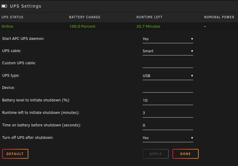

Another observation after looking at your settings.  If you are in a part of the world where the electrical supply are reliable then you need to rethink how you want to set up your UPS.
What I am referring to is that in these areas, there are two types of power interruptions.  the first type is caused by the protection circuits controlled by the Power supplier.  These will normally last less than ten seconds.  The second type is the uncontrolled type (caused by things like wind storms, lightening hits, drunks driving into power poles, etc.) and they can last for anywhere from thirty minutes to days.  (Back in a ice storm in 2004, we were out for TEN days!!!!)
The consumer type UPS can only protect against the first type.  Recognizing that is often a big step for most people.  Once you do, a case can be made for shutting down the system after the power has been out for anywhere from thirty seconds to three minutes on battery power.
Why would you want to do this?  Because if you run the server on battery until only 3 minutes of battery charge is left, it will take between eight and twenty-four hours to fully recharge that battery after power returns.  IF you only wait ten minutes after power returns before you restart your server if a second power outrage were to occur, you may not have enough battery reserves to shut the server down.
Another factor is that is very hard on lead-acid batteries to do a deep discharge unless they are designed for it.  Another factor is that these batteries do lose capacity as they age.  So your indicated three minutes of battery charge may on be thirty seconds resulting in an unclean shutdown.
Excellent point!
I actually wanted UPS to start clean shutdown after 3 minutes not until 3 minutes are left on the battery. Need to adjust the settings.
