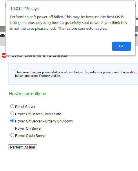

Recently I have had unraid go full unresponsive on me a couple times. Webui gone, no SSH, can't ping, not visible to my router, no video output, but still powered on and active. Trying to restart from IPMI give the error below.
First unclean shutdown was 31Mar, 12TB parity check finshed 02Apr @ 5am. Crashed again 04Apr, parity check started at 2pm. Server unresponsive again this afternoon 05Apr 6pm. When I rebooted I get a notification that the parity check finished with 0 errors (Average speed: nan B/s), I assume it failed. I've now rebooted and the parity check is running currently.
