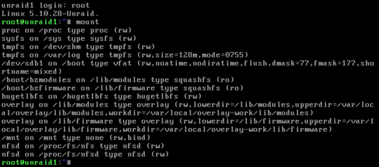

Ok, so heres the latest.
I went back to basics and scanned the USB stick for errors which there were some.  Ran the fix disk error wizard and voila, no more kernel panics.
The new problem is the Web UI won't start and while I can ping and SSH the box, I can not access my data because (me in my infinite wisdom) never set the array to auto start.
Screen shot of my mount status below.
Would love some suggestions please!

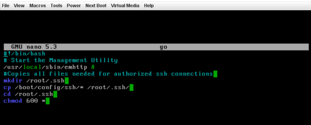

Have you booted into safe mode no gui from the syslinux menu?
What is the contents of your go file?
cat /boot/config/go
cat /boot/config/go
Thanks for getting back to me SimonF.
Yes, I tried safemode - same result (web UI unavailable)
Contents of the go file are as follows
