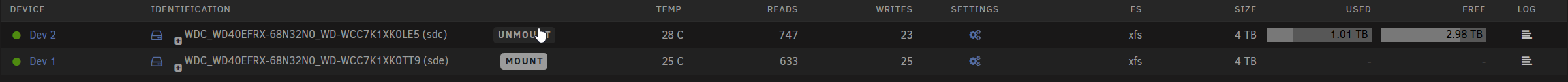

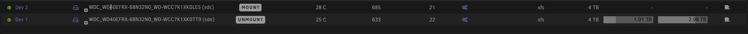

Now array drives are not specificed anymore.
I have 2 drives (WD Red 4 tb) which acted as parity / data drive.
firefox_aRxTb23371.thumb.png.aa72ffa7ca60a97ada1e8939db593028.pngfirefox_9LstTjbSni.thumb.png.afd6389945218d3241e8c19125b9e7f9.png
As you can see I can mount both of them.
When I select one as Partiy and the other as data (tried both possible solutions) I get following hint:
All existing data on this device will be OVERWRITTEN when array is Started
could you help me out how I find out parity / data drive?
br,
distel
With only one data drive parity works as a mirror, you can assign either one as disk1, the other as parity, and before array start check "parity is already valid".
