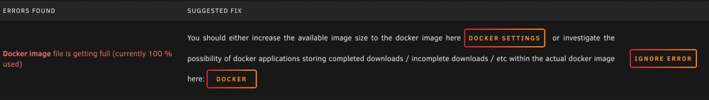

Thanks - so I had already restarted by the time i saw this but i did run fix common problems and i guess i do have something misconfigured as you will see in the screenshot. that said, i'm not sure where exact;y the problem is.
Attached is the diagnostics per the request - i hope it has sufficient information but just in case ... here's what i'm trying to accomplish:
- My cache drive has an appdata share and a downloads share created on it. The appdata share is set to only for cache and the downloads is set to yes.
The idea is that my appdata share houses all of my docker configurations and then the downloads share is where anything is downloaded to first before being moved to my data drives.
Will post anything else you need. Thanks!

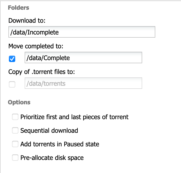

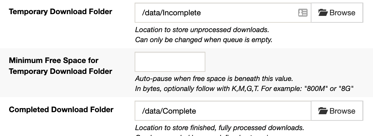

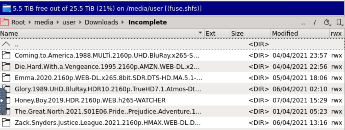

attached is the SAB config for downloading and the deluge settings - as well as a screenshot of my Downloads/Incomplete share where incomplete files seem to be stored.

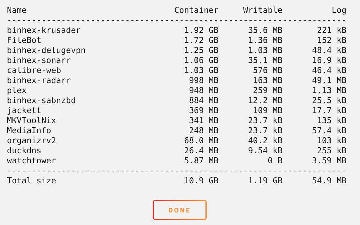

What does it show when you hit Container Size on the Docker Tab
15 minutes ago, helpermonkey said:
been using unraid and docker for the same amount of time
You joined the forum years before docker was part of Unraid.
That all looks OK, but I don't use those (NZBGet and transmission instead) so I don't know if there are other path settings you aren't showing.
What he said

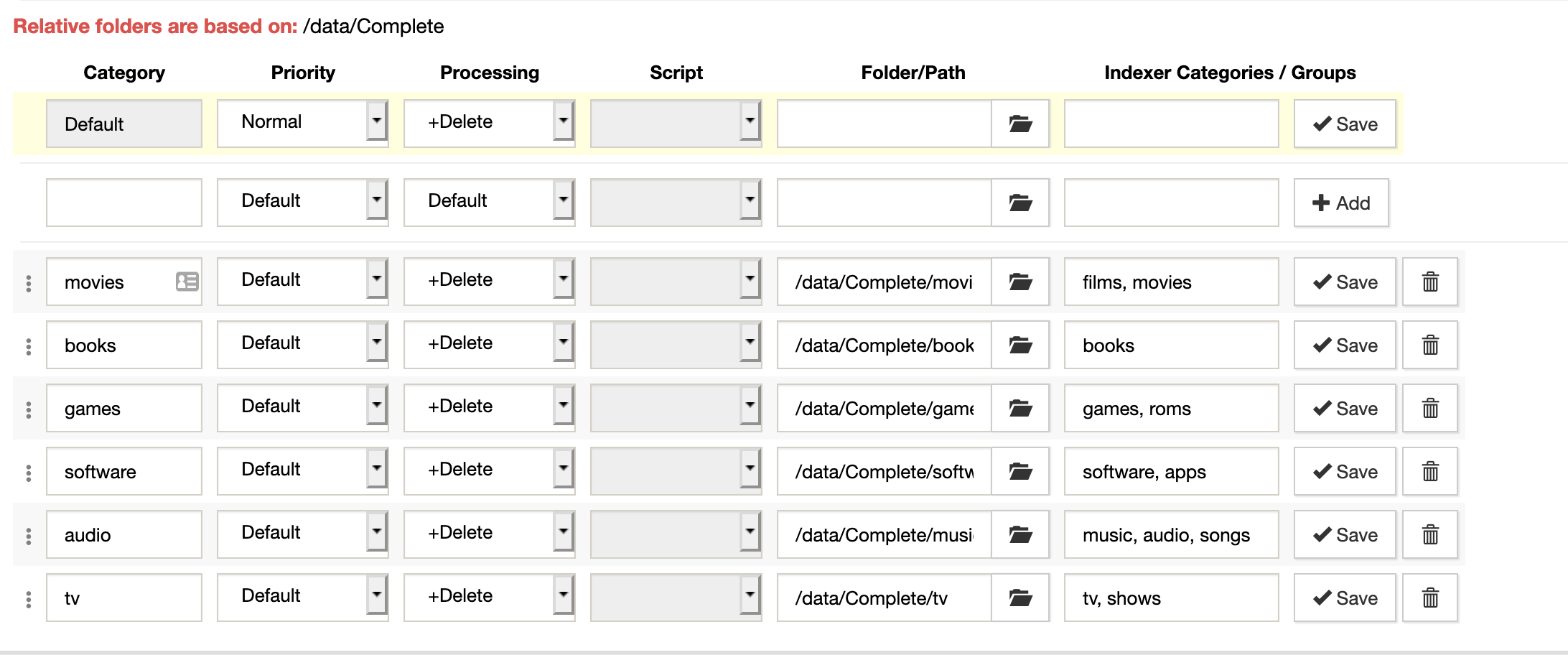

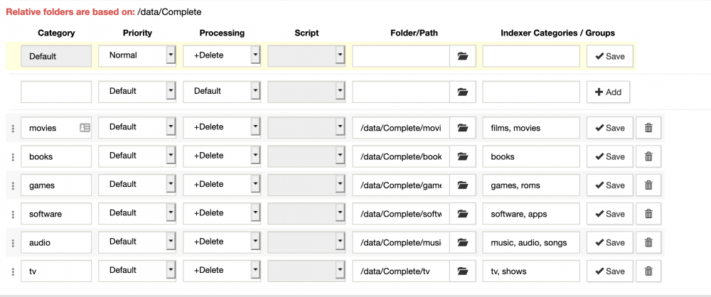

I'm pretty sure i signed up well before i started actually using unraid - it's entirely possible that i've been using one longer than the other but to the best of my memory i didn't actually start playing with this until docker was incorporated. Then again, I can forget my own cell phone while i'm holding it so i wouldn't be surprised if that wasn't the case. the only other path settings that take place inside sab are on the categories page - which i've included a screenshot of now.
Here ya go:
439764742_ScreenShot2021-04-07at17_34_11.thumb.png.8a993ba653863919b3d845628b43011e.png

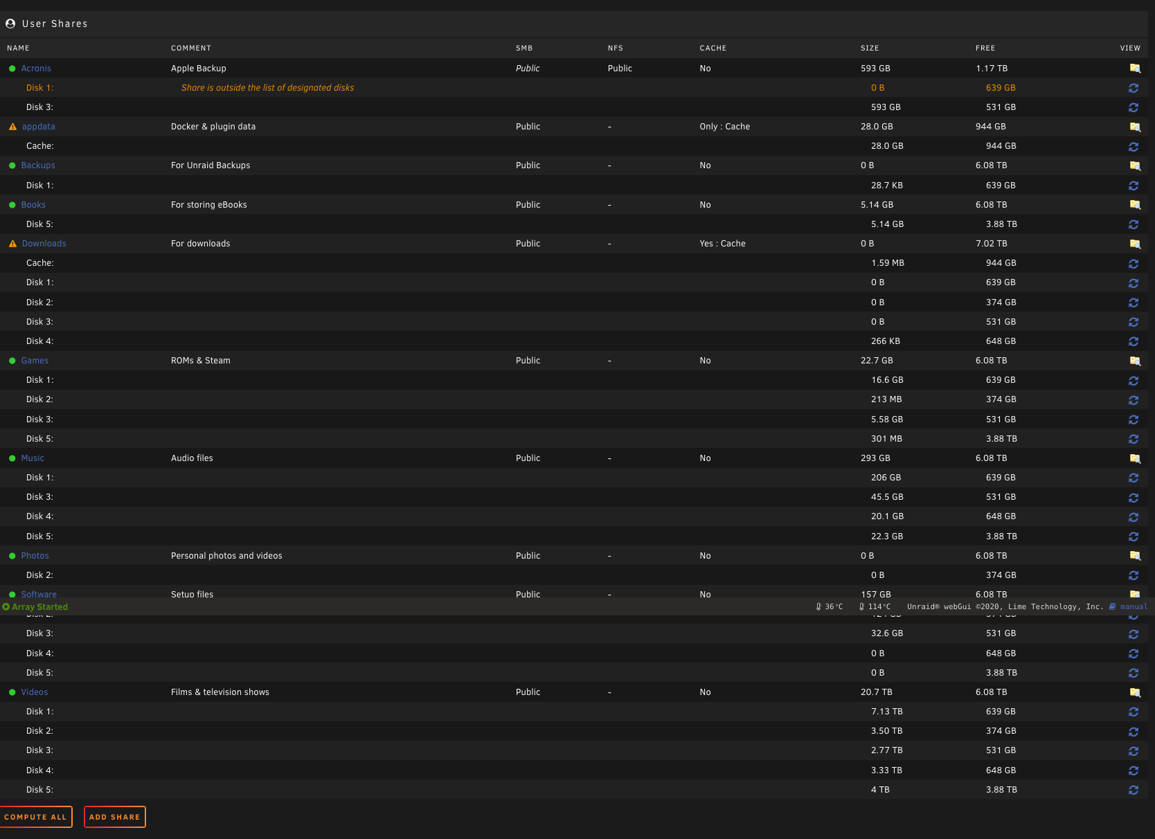

Here's another screenshot that shows my shares and their sizes ....
1411924796_Screenshot_2021-04-07BuddhaShares.thumb.png.addab860fb5cbd1652787ffd091b05a3.png

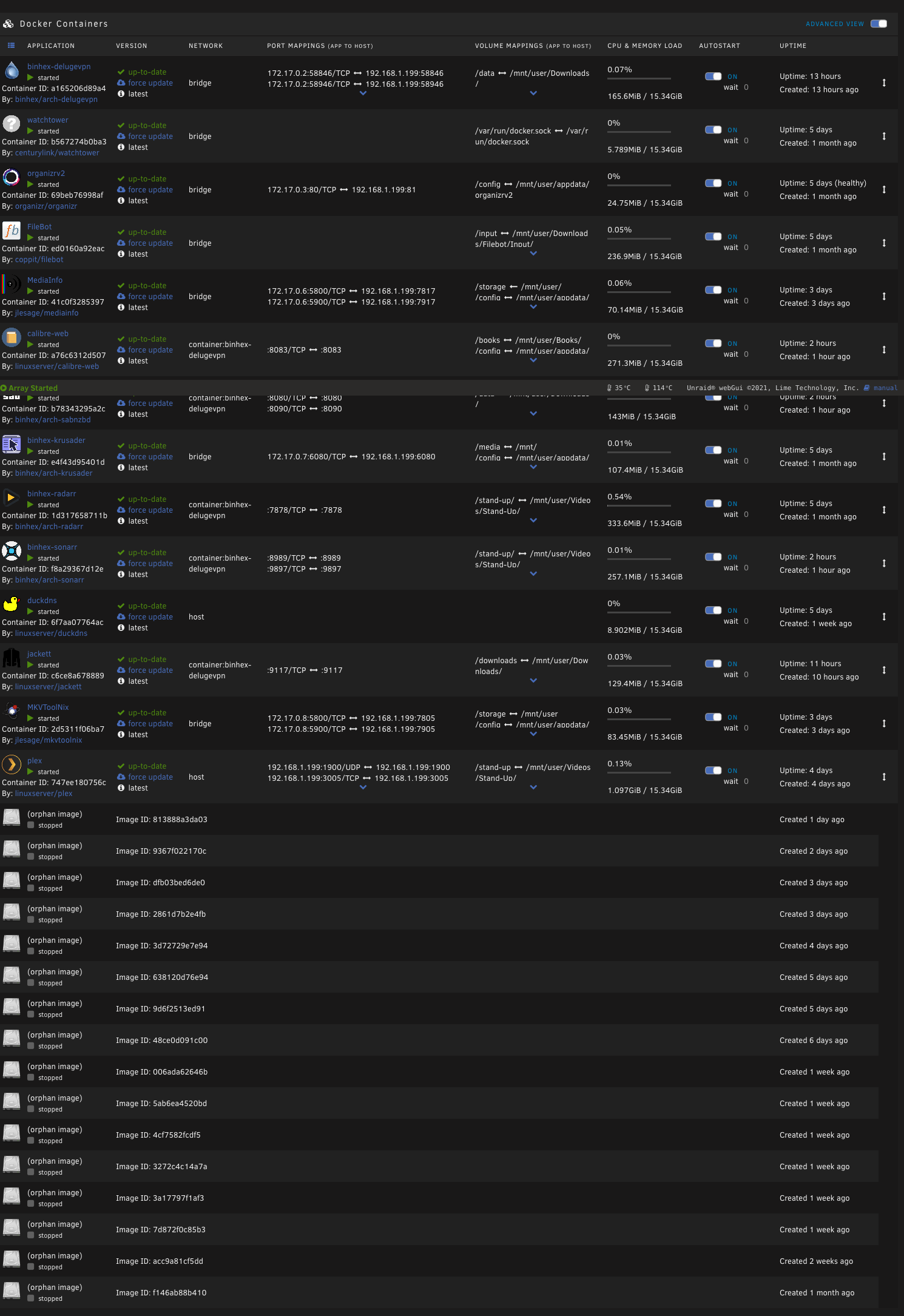

Post a screenshot of the Advanced View of the Docker page.
Here ya go
2049475970_Screenshot_2021-04-17BuddhaDocker.thumb.png.29aa4035f17de3caf1e6142874a8e8f1.png
2 minutes ago, Squid said:
Delete all the orphan images by clicking on them
roger - that's what i did last time this was a problem - what exactly are orphan images and how do i keep them from sticking around?
They are the images that are created when the docker run command produces an error (ie: you had an error in the template and the app couldn't run)
roger - so should i just check in on the advanced view from time to time? I am guessing these errors aren't big deals?
