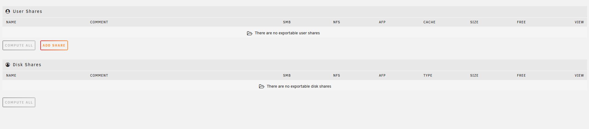

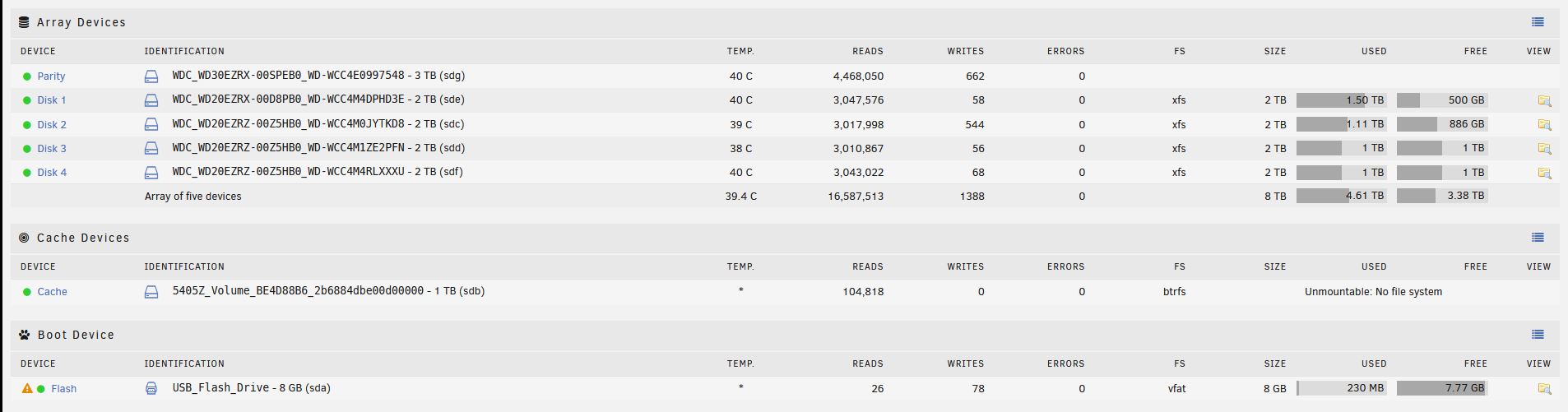

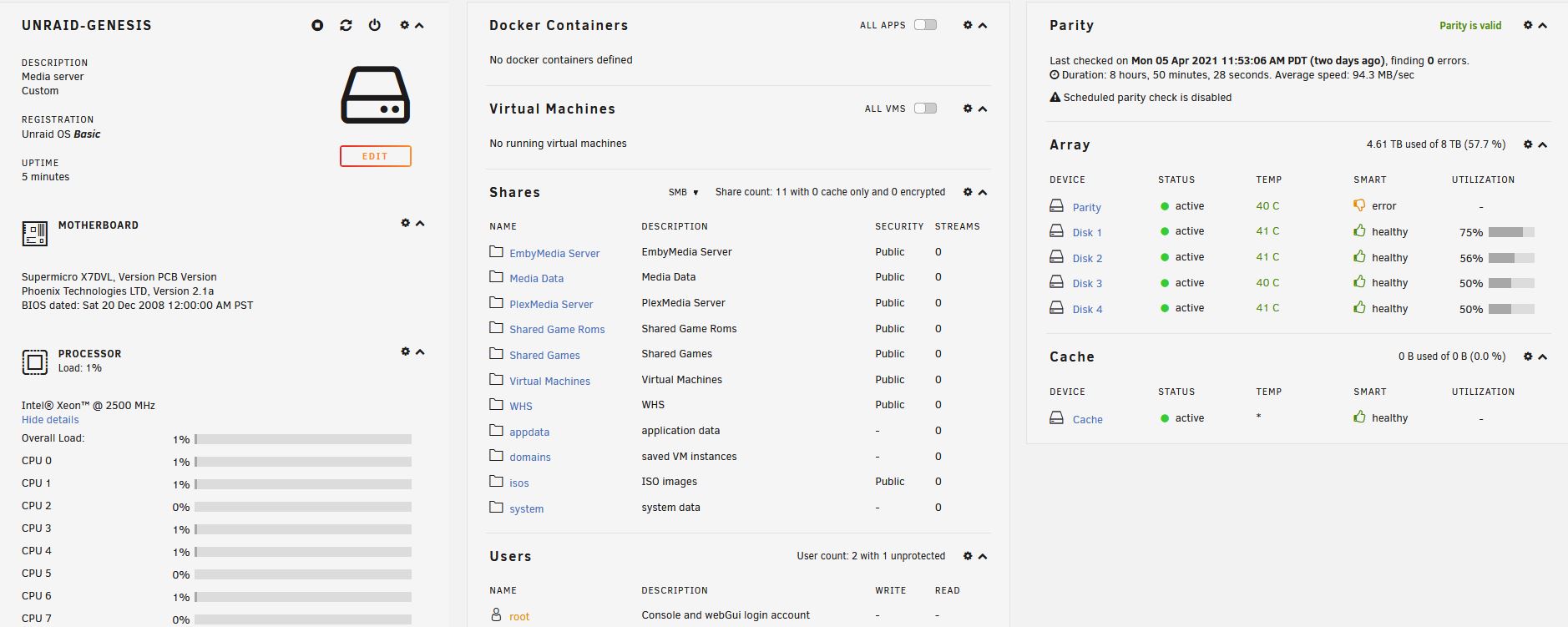

I recently created a a share and transferred data to it but got a message from Unraid 6.83 stating the cache drive was almost out of space. I turned off the cache on the share volume. Stopped the array and shutdown the server and then rebooted the server and data is now missing. I then shutdown the server for a few days and booted up today now all the shared folders are missing. But oddly the main screen it shows the array is online with the exception of the cache disk. It also shows the total size of the array and how much space is used and what is available.  Please see attached photos. If anyone can point me on how to recover the data it would be appreciated.

Shares are not working because shfs segfaulted, rebooting should fix it.

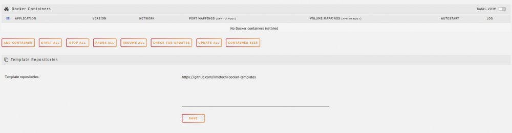

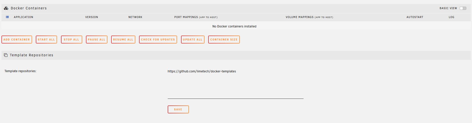

Okay, rebooted and the shares returned, thank you. But I am still missing data and the docker for unifi controller has not returned.

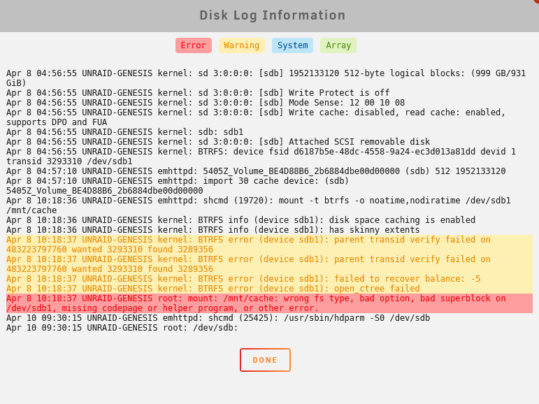

[9:0:0:0]    disk    Adaptec  5405Z Volume     V1.0  /dev/sdb    999GB (Cache Drive) - (Cache Drive Unmountable: no file system)
Use /dev/sdb1, also note that using a raid volume for cache is a very bad idea, btrfs should have direct access to the actual devices.

Best chance of recovery for that issue is btrfs restore, looks like you tried everything except that, including check --repair which should only be done as a last resort.
