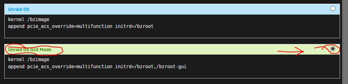

I have my UnRaid OS congigured to boot straight into GUI mode as shown in screen capture below. The problem is my UnRaid OS GUI is not appearing on my monitor that is directly connected to my Nvidia GT1030 card. Nevertheless, everything remains black on the monitor because of a lack of signal.
The only way I can get control of my UnRaid OS is remotely on my Windows10 client's FireFox Browser. In short, my UnRaid OS is behaving as though it were a headless unit eventhough I have it setup to function as a stand alone PC.
My Nvidia GT1030 card is passthroughed and the monitor connected to it successfully displays my Ubuntu VM.  So if I can see my Ubuntu VM on this monitor shouldn't I then be able to see my UnRaid OS pre-boot process take place on this monitor and then finish with my UnRaid OS GUI on full display?
In short, my goal is to use my UnRaid Server as as a standalone PC, but right now it behaves like headless unit eventhough I have it configured to boot straight into the UnRaid GUI.   Any help from anybody in the community will be welcome.  I need advice on what configuration changes I need to make so I can use my UnRaid Server as a standalone PC. Thank you for your time.
