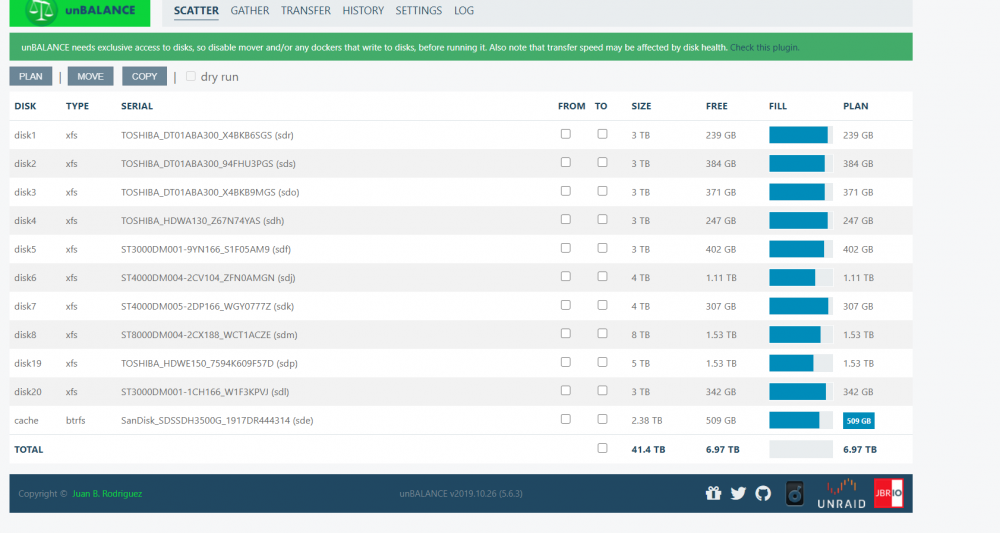

The Unbalance plugin will allow you to move data from the 6TB drive to others. As long as the same shares are used for PMS you will not need to change when you move the files as will still be in the same share.

As ChatNoir said you can and say use mc, Unbalance allows you to move from one disk to many or from many to one.

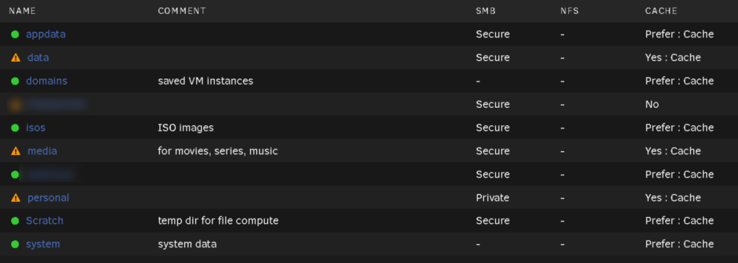

Hmm... I do have a 1Tb SSD I could add. Would it make sense to do something like partitioning part of it (half?) to be a cache drive, and leave the other part for holding appdata or whatever?
No need to partition, a single disk can manage both. Set appdata and system to Prefer:cache and the share you want to cache for data transfer to Yes:cache.
For example, I only use a single disk pool for this.
