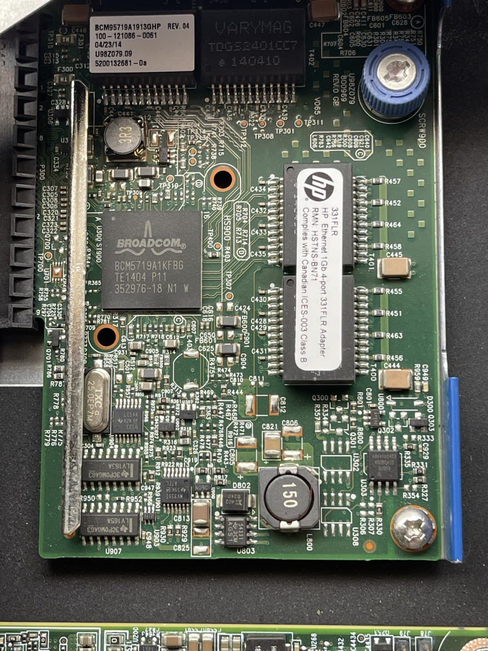

The network card: HP Ethernet 1Gb 4-port 331FLR Adapter https://support.hpe.com/hpesc/public/docDisplay?docId=emr_na-c03225667
Unraid does not boot properly. no network access and booting into GUI does not help.
In the CLI I was able to see the PCI network card and I do not see any ethX interfaces therefore the br0 interface has a 169.. address
Is this not a good card to use? Is unraid just missing drivers? could drivers be added?
I just bought like 12 of these servers on ebay (don't ask :( ) so I don't really want to buy NICs for them now.
I also tried changing the network.cfg file to a static IP and/or also "no" for bonding and bridging but that did not help.
I tried a couple of servers and they all don't seem to work including HP Proliant ML310e tower I bought.
I also tried booting a ubuntu live usb on the server and that worked no problem with the NIC.

Yep, no driver for that NIC, you can make a request, LT is usually quick to add them, if one is available for current Unraid kernel.
Ok cool. Can I ask how you know or where you looked? maybe useful for others if they are in the same boat as me.
NIC appears in the device list (system/lspci.txt in the diags) but no driver is loaded.
