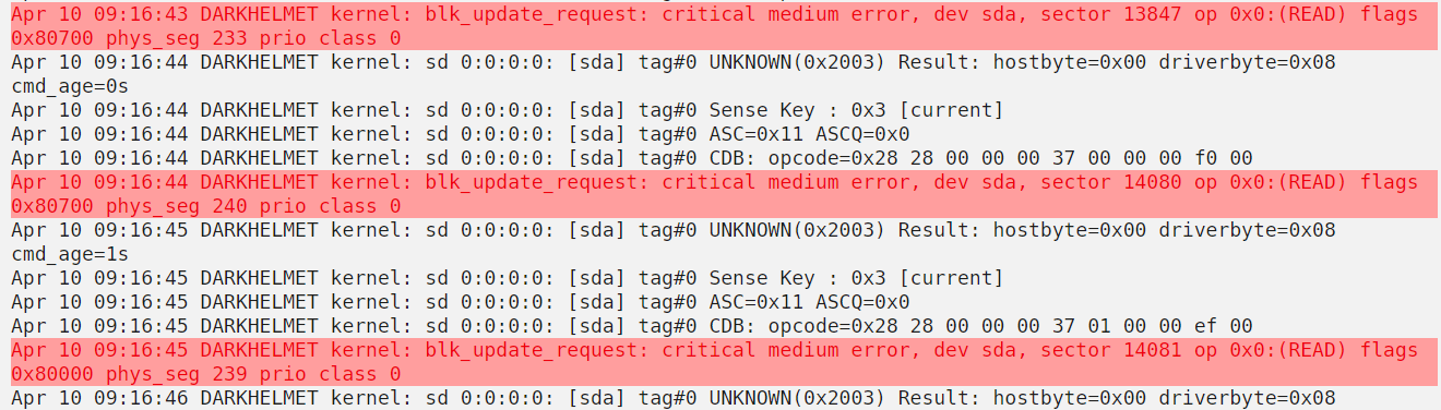

I had a very similar situation this morning. I pulled the plug today for replacing a "bad" flash disk, 32GB Usb 2.0 SanDisk Cruzer Fit. I replaced an old/cheap drive back in June of last year, that was actually bad. So I had to go through support to get reinstated. So not as hassle free, but they were pretty quick to respond and get me fixed up!
Anyway, I was getting read errors:

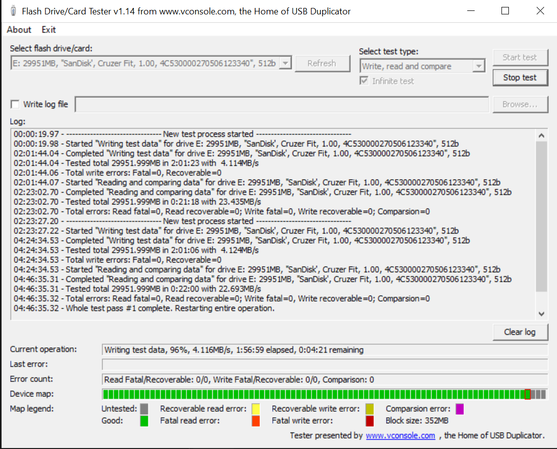

I thought for sure the flash drive was dead, because when I plugged it into my Windows machine to yank the config file at least, but it hosed it up proper. Windows explorer crashed, I couldn't get into disk management, nothing I tried would allow me to see/access the drive. I called it, and went ahead with replacing it with a backup Cruzer I have still NIB. Then a while later, I got curious, and fiddled with it more. Obviously the flash drive had a chance to cool down and such. But its been solid read/write/verify testing for nearly 5 hours now without a single error. So, looks like I may have prematurely replaced it, but not sure why it hosed up so bad to begin with.
Server is going good now, no more errors. Just thought I'd tell my story as well, just in case someone else has similar errors pop up. It may not be the flash drive.
