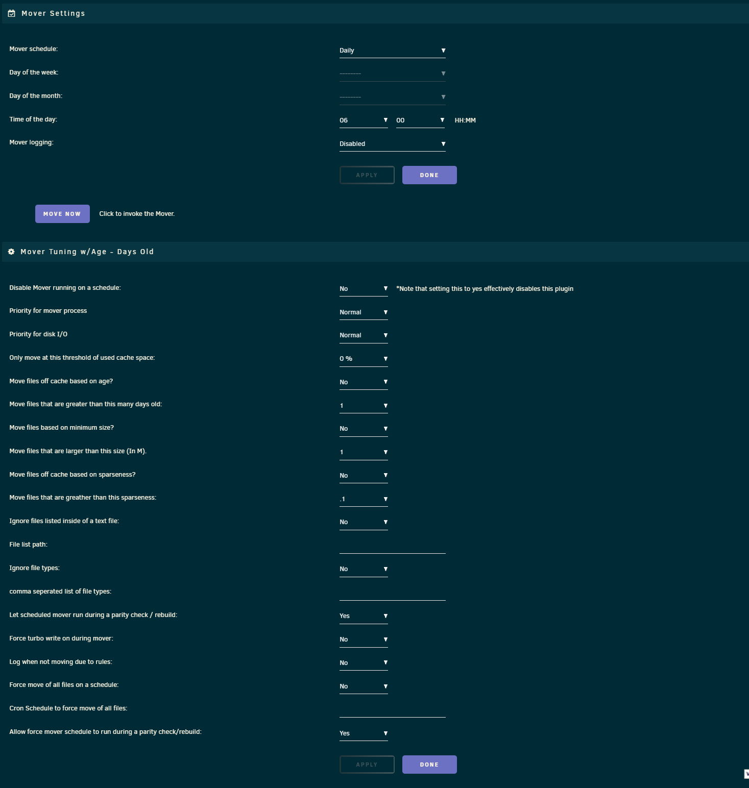

i noticed that my mover was not moving my shares to the array.
It just stays on the cache.
If i start the Mover it just Logs this:
"Apr 9 20:59:24 NAS emhttpd: shcmd (210): /usr/local/sbin/mover &> /dev/null &"
The Mover just stops directly after it is triggerd.
I tried to set the shares to not use cache and then back to yes.
But Problem stays the same.
I also rebooted with out any difference.
If i copie the files directly to the array there is no problem at all.
The Problem happend properly some Version ago as my latest files are from 2020 and i have a daily schedule on the mover.
Not sure what steps to make next. Would be thankfull for an advise on this.
Thanks Salamy
Edited by Salamy
Yes it is installed.
You should post in the plugin support page. If you are not using any of the plugin functions if you remove it will run stock unraid mover.
I think others have been reporting on the plugin page of some issues.
Thanks for that hint. I have installed the plugin since day one and never looked at it.
Just removed it and now everthing is working again.
I feel stupid of not trying this on my own.
Your my lifesaver 😃
