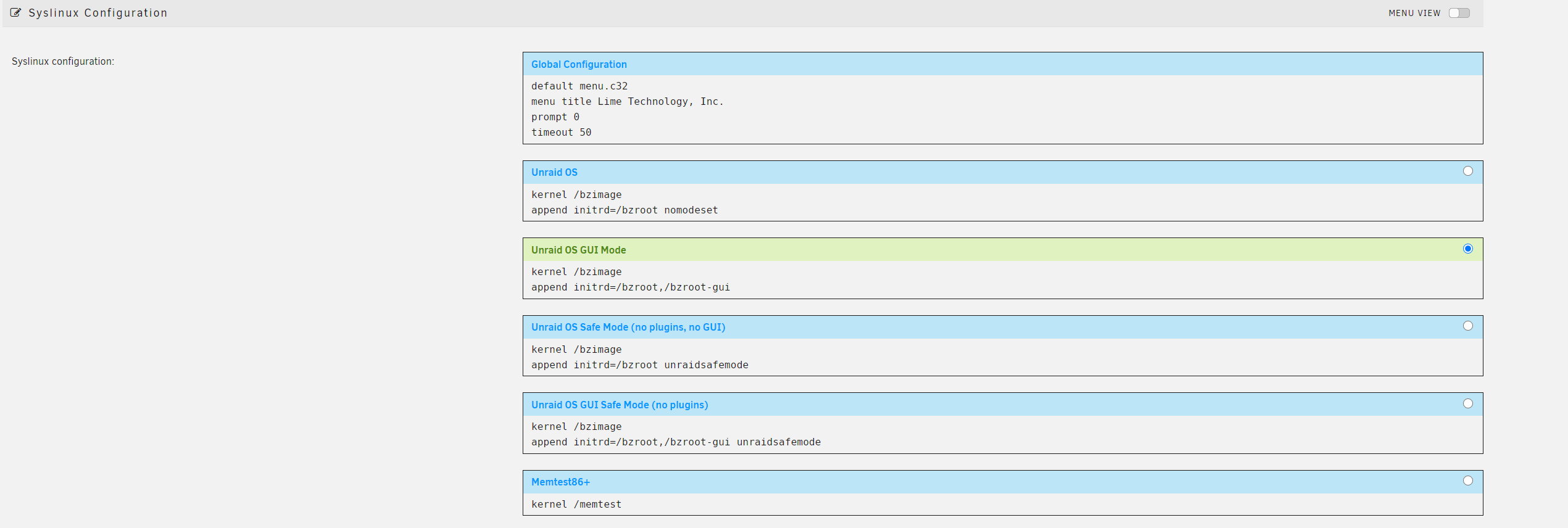

If you always use GUI mode, then set it as the default via Main, Boot Device, (click on Flash), syslinux configuration
In the syslinux configuration section, how do you switch it to boot in GUI mode?
Click on flash drive in the main tab and select GUI option
Feel like a dumb ass lol....the bubble to the right you have to click was off the screen. Thank You!
