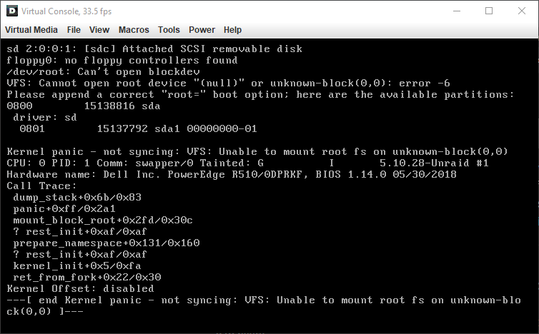

I just upgraded my Unraid server to version 6.9.2 from 6.9.0. After a reboot I was greeted with a kernel panic:
kernel panic - not syncing: VFS: Unable to mount root fs on unknown-block(0,0)
After flashing and testing another flash drive, I got the same message. I then flashed version 6.9.0 back on to the previous flash drive and everything is now working again. I am yet to run memtest, doing that when I go to bed in a couple of hours and leave it overnight, but I do have ECC memory so isn't that supposed to self-correct errors?
As I don't really have the money to buy a new server, I want to keep this *** running for as long as I can. So if it means not upgrading, so be it.
Attached is a screenshot of the kernel panic.

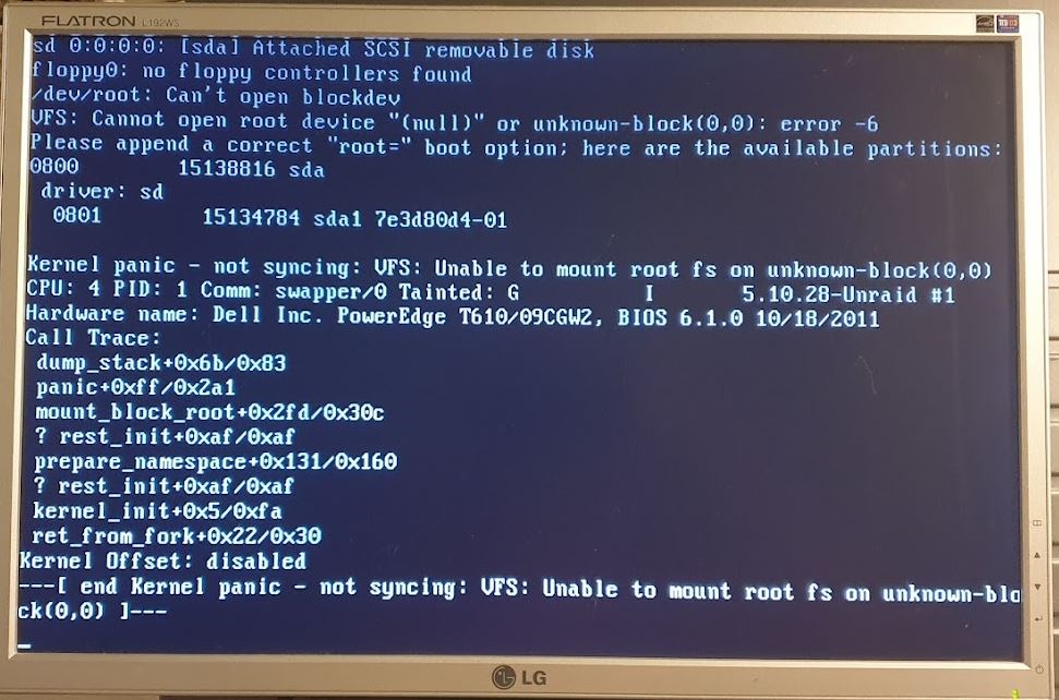

Hi, today I was updating the unRaid OS (new update today?) and got the same problem as xylcro above. Should I roll back to previous  verision? Or changing USB memory again? Do I have to change USB memory every time I update the OS? (I think I had the same problem last time. Or similar.. )
Edit: no, it was about LZMA corrupt (formating the USB-memory fixed that one).
