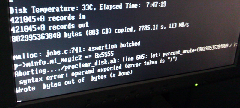

This isn't good.  I think it's a problem with the preclear script, not the drive itself.  The script is still running, but I get this message refreshing every few seconds.  Should I force it to quit or just let it keep going?
If "malloc" is failing, you've run out of free RAM.
I'd quit it.  There are options to limit the number of blocks read, and the size of the blocks read and written.

Weird.  I've got 2GB of RAM so I shouldn't be running out.  The script was still making progress when I left for work.  If it's still going when I get home, I may just let it finish on its own.
When I got home the preclear had completed with no problems that I could see.  I suppose this is "solved" for now.
