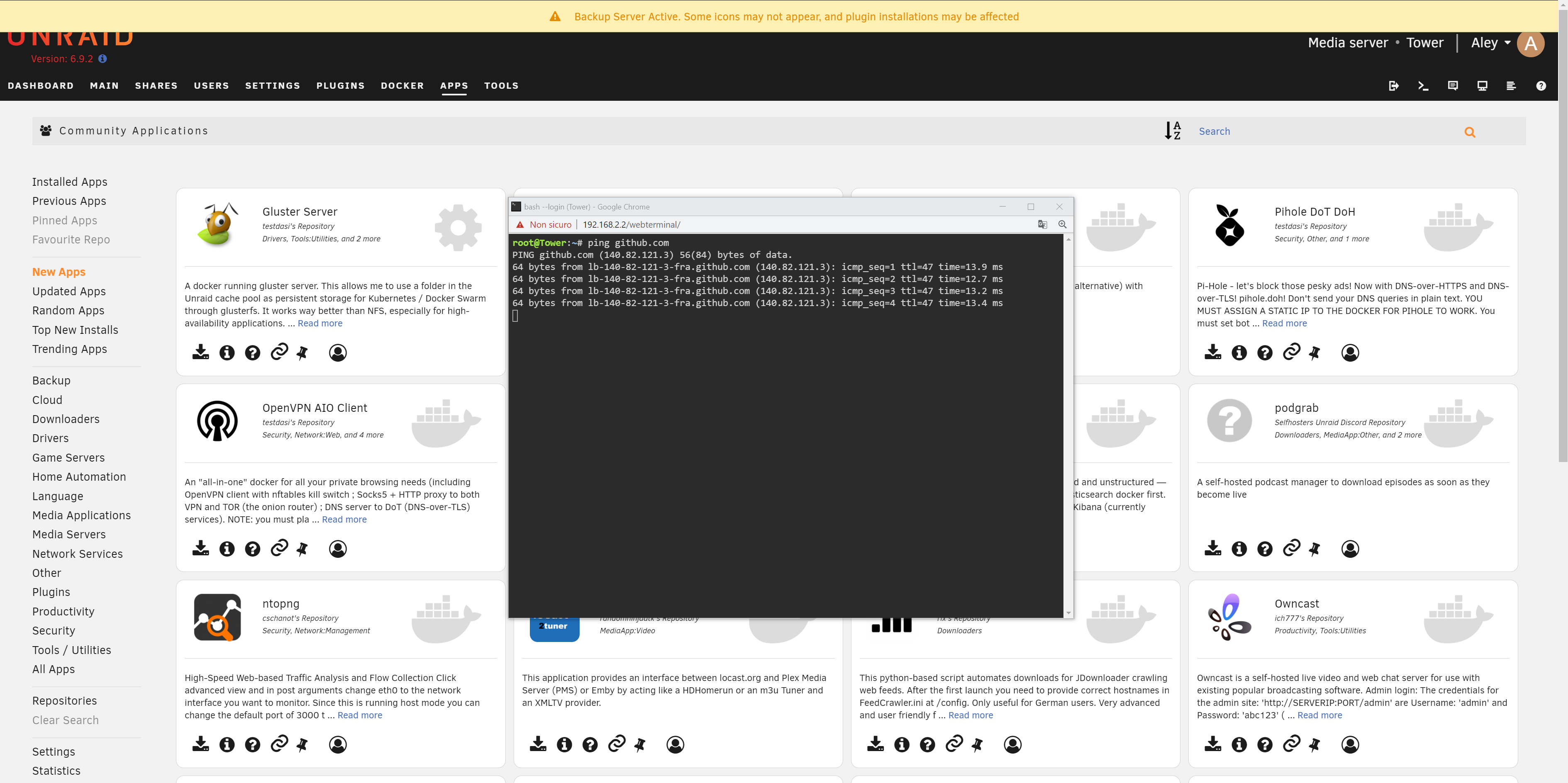

App screen not flashbackup (see image):) when i click on App i see a yellow line on the top: "Backup server active...."
i read unraid can't resolve github.com but when i open terminal and ping github.com it resolve whitout problem
