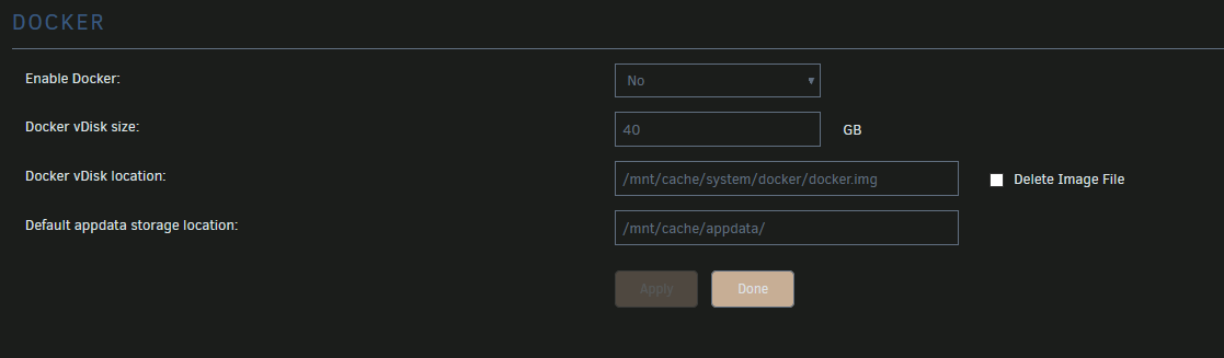

@itimpi Ok I got it. If I set the AppData, Transcoding, and System to Cache=Only it makes it fixed to the Cache Pool Drives. Now for AppDataBackup it was set to Cache=No but would that be on the Cache too?
This is the way the docker is set so I am correct on that????
This is quite typical.   By using /mnt/cache you are referencing the physical drive directly and bypassing the User Share system.  However since each top level folder on any drive is considered part of a User Share then files will also show up under the 'appdata' and 'system' shares.
You always have two ways of viewing files - directly by going to physical drive and a separate logical view at the User Share level that gives an amalgamated view across drives.  They are still the same files.
I was told a while back to put the appdata on the /mnt/user section but it seemed strange to put the working docker files on all the drives. I want to make sure I have the most optimal way to setup UnRAID to perform without any major issues that affect the system files or docker containers. The 7 storage drives are just for media or data only to spread out across all disks designated for media. Mainly the User Share is for the storage of videos, music, and media files for Plex.
This is normally recommended because then at the application level you do not have to worry about what physical drive contains the files and they can be moved around without having to change application settings.    It does not mean that you WILL have files on all the drives - that is controlled by the Use Cache setting on the share.
Ok that made it more clear so I will keep it as the recommended setting of /mtn/cache and set those system shares to cache=only to the cache pool. All other stuff will be User Shares to 7 main drives with it set to Cache=yes to use the pool to move files off and on the shares.  Thanks for all the help, much appreciated.
