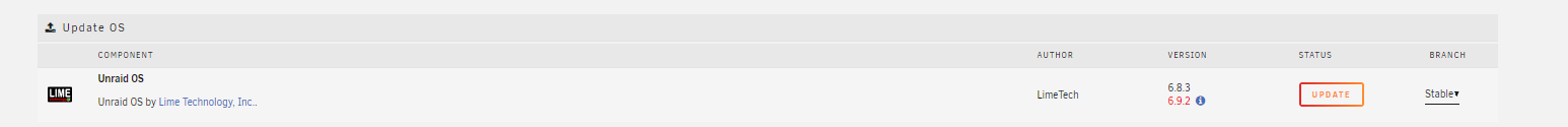

so i tried again and the following happens, i stop the array and push the update through so on the update screen it will display that the update has been successful, image below just for reference to where i am referring to, but ever time on reboot it seems to not upgrade and stays on version 6.8.3
I also followed the below forum page to manually upgrade but again it doesn't upgrade when it goes to the boot screen it still says 6.8.3
but after i pushed the update and reboot, the server then becomes unresponsive to pings and the GUI cannot be loaded also tried to load gui in safe mode
