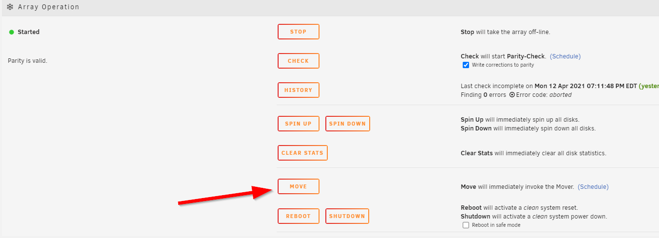

I originally setup my Unraid server without cache drives. I ended up adding 2 cache drives into a pool after the fact. I changed the settings on 4 shares to prefer cache. The 4 shares were appdata, domains, downloads and system. I use a qbittorent docker to download torrents that go into the downloads folder and then I move those downloads into the respective share they ultimately go in like lets say tv shows. The problem I am having is that my cache is filling up (74% full) even though I have moved the files (using binhex Krusader) to the respective shares that aren't on the cache drives (some files still show they are on the cache drive if I use the browse files feature on the shares tab for the tv shows share). The mover does nothing at all. According to the logs as soon as I start the mover it finishes instantly. I have even changed around the type of cache that the download share is set to and that still does nothing. Some direction regarding this would be greatly appreciated. It is probably something simple but I'm just not figuring it out.

Check if you have mover tuner plug installed button is same for both

I would suggest that you enable mover logging under Settings -> Scheduler; try the move again and then you are likely to get better informed feedback if you attach your systems diagnostics zip file (obtained via Tools->Diagnostics) to your NEXT post.

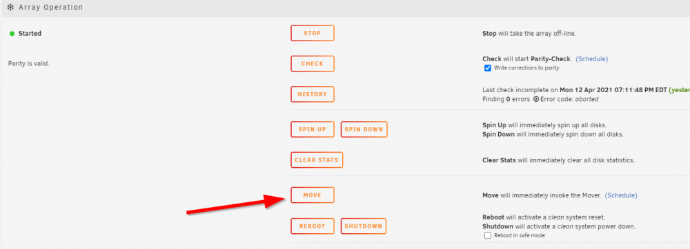

So I set that to yes on both those shares and invoked the mover and it is indeed moving the files. So in the future if I don't want this to happen I should turn of the downloads share to NO for using the cache otherwise I'm just going to have to do this if I move from downloads to other shares? Or is there a better approach?

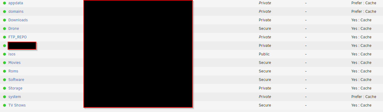

So this is how I set mine up after the mover completed. I also setup my mover to schedule a move operation at 3:30AM once a week on a Wednesday.

Those look sensible.
Once you get your head around the concepts then it is easy to later make changes if your needs change.
As to the frequency at which mover runs then it really is up to you and your usage pattern.  The key point is to run mover at a time that has minimal impact on your use of the system and it does not have so many files to move that it is still running when you want to start using the server for other things.   If you leave your server powered on 24x7 then the default of every night at around 3:30 is as good a time as any.    If you have plenty of space on the cache drive for the amount of new files you accumulate then less frequently is fine.
You should set the Minimum Free Space value for the cache and for any share to be greater than the largest file you expect to have.    That way unRaid will transparently switch between using cache and array without failing transfers due to insufficient space for a particular file.
