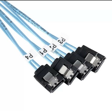

These are the $17 cables - I had them looped, bunched together & cable tied, the wire in them is very thin & not very flexible
No errors since last night when I took the sides off the case, cut the cable tie & freed them up
SMART short self-test: healthy

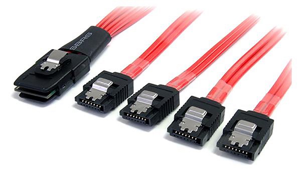

Would these $50 Startech cables be any better ?  - they look more like standard sata cables
and a bit more insulated & forgiving, for when I put the sides back on the case
These red ones, are not they reverse breakout?
StarTech Mini-SAS to SATA Cable, 1x SFF-8087 Plug, 4x SATA Female - 50 cm
The SAS8087S450 SFF-8087 to 4x SATA SAS cable features one 36-pin plug (SFF-8087), which fans out to four SATA 7-pin receptacles, providing a reliable solution for connecting up to four SATA HDDs to a SAS controller or backplane
The same type as the cheap $17.50 Krysma 50cm / 0.5m Mini-SAS SFF-8087 to 4x SATA Adapter Cable I'm using
You know they do look alike & don't seem to specify forward or reverse .. other than "one 36-pin plug .. fans out to four SATA"
from https://www.startech.com/en-au/cables/drive/sas
"SAS8087S450
50cm Serial Attached SCSI SAS Cable - SFF-8087 to 4x Latching SATA
Connect a SATA/SAS Controller to 4 SATA drives"
Reverse would be SAS Controller to 4 SATA motherboard
looks good. every company do they own cable coloring. in my experience red cables are usually reverse ones. but if they clearly states, then should be fine.
