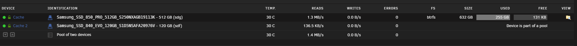

Hey Guys,
Yesterday I added a second SSD to my cache pool. It used to be only my Samsung_SSD_850_PRO_512GB, but now I added my old Samsung_SSD_840_EVO_120GB. My Pool is brtfs (encrypted), I got a warning, that if I add the 120GB SSD to the pool I will loose all the data on it (which is expected and perfectly fine).
After bringing the Array back online I expected it to format the data etc. unfortunately it seems like something else happened.
Do you guys have any ideas how to resolve this, right now all my self hosted services are unusable because they are running from cache.

I assume this is because I added the new drive, but at 18:11 I got the warning:
Event: Unraid Cache disk disk utilization
Subject: Alert [SERVERNAME] - Cache disk is low on space (92%)
Description: Samsung_SSD_850_PRO_512GB_S250xxxxx (sdg)
Importance: alert
followed by more warnings (95% until 100%)
First thing I'm seeing is, that the Size is 632GB, used is 255GB and free is 131KB, so something went wrong here.

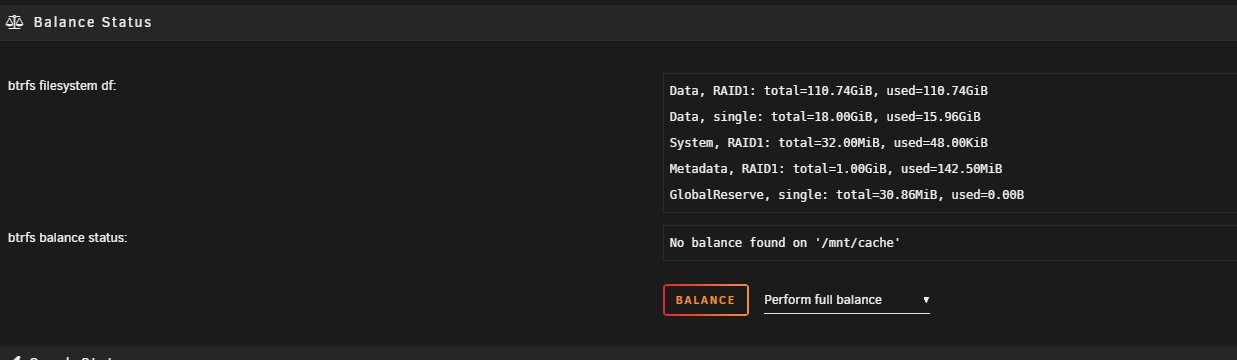

Balance Status (after running Perform full balance):
output of "btrfs fi df /mnt/cache" after running "Perform full balance" on the cache
Data, RAID1: total=110.74GiB, used=110.74GiB
Data, single: total=18.00GiB, used=15.96GiB
System, RAID1: total=32.00MiB, used=48.00KiB
Metadata, RAID1: total=1.00GiB, used=142.50MiB
GlobalReserve, single: total=30.86MiB, used=0.00B
WARNING: Multiple block group profiles detected, see 'man btrfs(5)'.
WARNING:   Data: single, raid1
By default Unraid converts the pool to raid1 when you add a device, and raid1 will only use the capacity from the smallest device, if you want to expand the pool see here.
And I can only use 2x smalles drive size, so this absolutely doesn't make sense to add my second drive because it will actually decrease the size.
