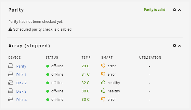

Thanks Frank, so I did get the old array into a new build with a trial license, and getting this on the dashboard:
On the Main tab, it says that when I start the array all the data will be overwritten.
Just to be sure you know what I have done up to this point, with disks 1-3, I mounted as unassigned device and transferred most of the data over to the new array. Had I realized that one drive would not mount I would have copied the data, but for ease of knowing what was transferred over, I moved it all.

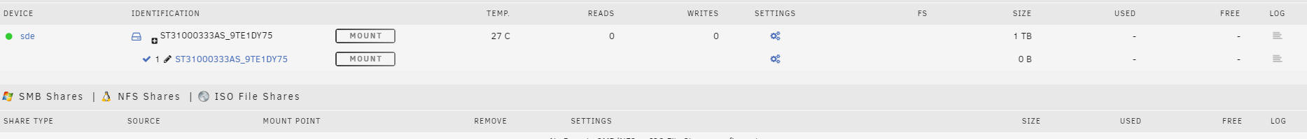

Here is a screen shot of the drive:

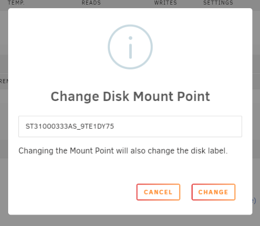

If I click on the blue link I get this message:
Looks like something I do not want to do.
That's just to change the name of the mountpoint, the problem is the mount button not being enable, post output of
