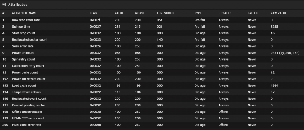

Short SMART test passes fine. here are the smart attributes of the drive:
Other than a lot of spin-up time (I've been meaning to switch my drives to not be always spun up), the drives looks like it should be OK.
What should my next course of action be? are there better tests i should run? will i be able to add this drive back into the array without too much hassle or am i going to need to wipe the drive and rebuild it from parity (assuming the drive is OK)?

Syslog doesn't cover the disk getting disable, but SMART looks fine so unlikely a disk issue, I would swap cables/controller with another disk to rule that out and rebuild on top.
