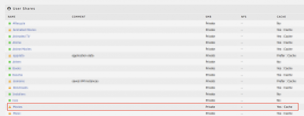

Hi there, I have a problem with the mover. It doesn't move files, which are stored on the cache drive. I don't know where I can find more precise logs, but here is what I have:

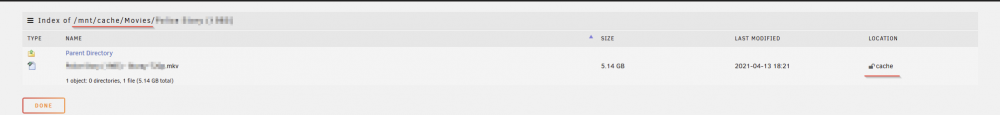

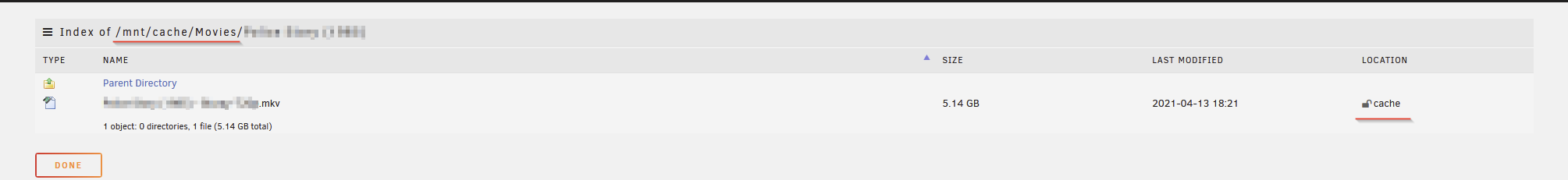

Several movies on the cache drive, here is 1 example

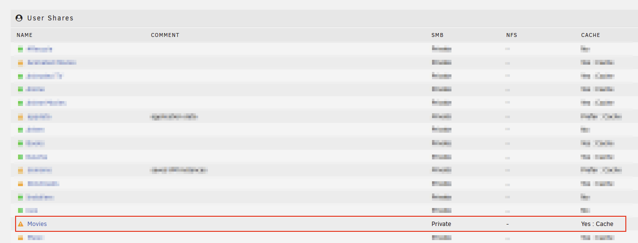

The folder Movies is set to Cache: Yes
When I click the "Move" button and refresh the screen, it seems that it has stopped the mover process. It seems to start, but doesn't really do anything. Here are the Logs I can see:

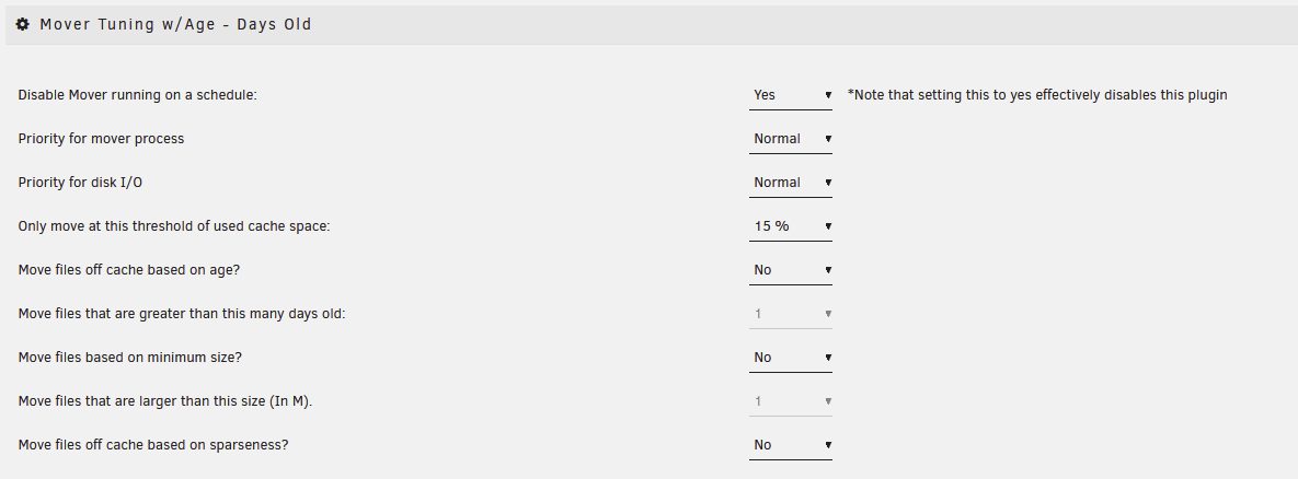

Do you have the Mover Tuner plugin?
Update settings or Remove should fix Mover.
Yes, you are right, thanks.  I was thinking, that this might be the problem, so I have set the Plugin to "Yes", thinking, it will disable the features, but the threshold seems still to block the mover process. I have changed it now to 15% and the manual mover start is working. Werid stuff. Thanks again!
