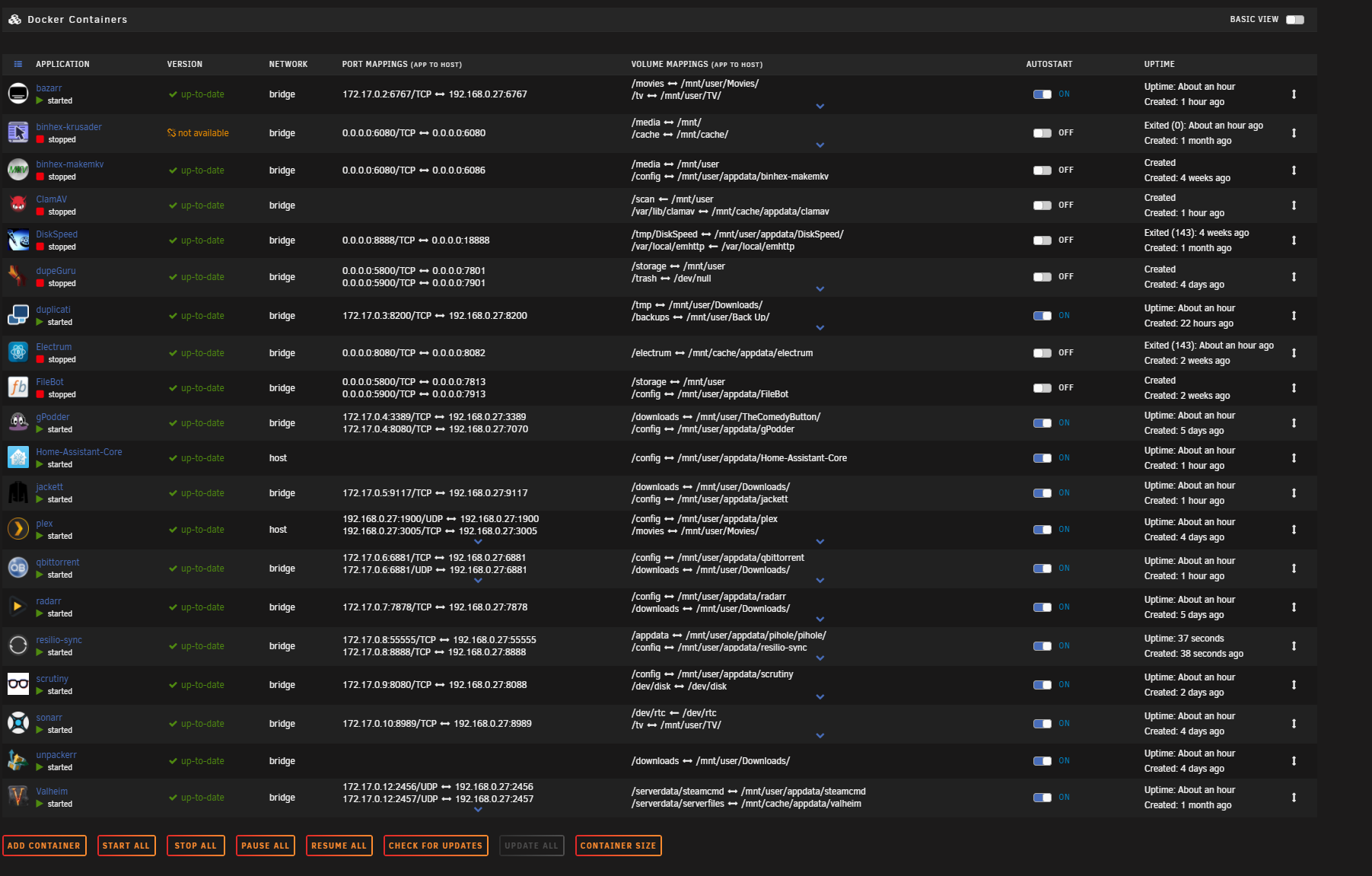

Had two br0 dockers both of which where disabled at the time of the panic. I have removed them completely this morning.
Would disabled dockers still cause issues?
If there are still macvlan call traces there's still a problem with that, unless they were old, syslog is spammed with NVIDIA errors so more difficult to analyze.
OK makes sense, Dockers are gone now. Attached is what remains. I have also changed form a bonded interface for my NIC to a bridge
