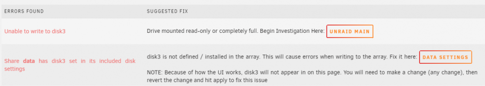

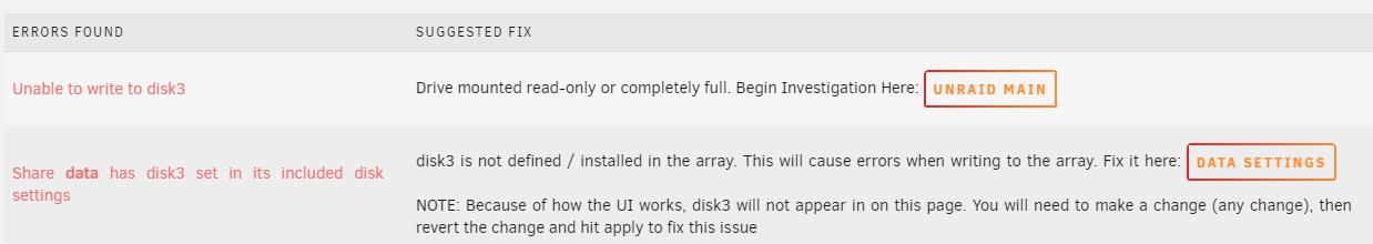

Problems again.  Does not say "not mounted" this time.   Here is what "fix common problems" showed:
But it is not full or read only.  It does say "disk 3 not defined/installed in the array".  Which sounds similar to unmountable.

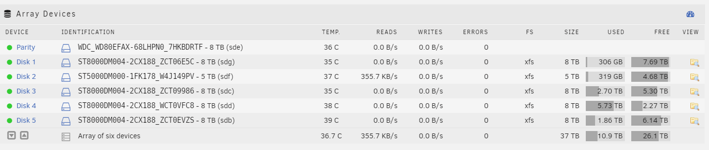

Here is my main screen
It looks normal.  When I get unmmountable error, it does not look normal like this.

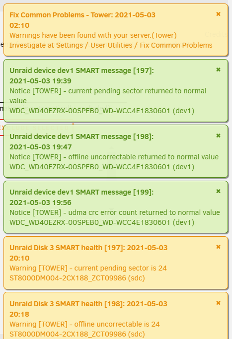

I am starting to think it is normal and common to Now I am getting orange warnings for the unassigned disk I just started using.  I got simialr mesages for other disks.  get these mild warnings (yellow, not red).  Bad orange, Good green, repeat, repeat.
I tried improving the power cables to the disks.  Next I may try to use more motherboard sata connections, and fewer of SAS to SATA i have using the approved "Dell H310 6Gbps SAS HBA w/ LSI 9211-8i P20 IT Mode for unRAID" which has 8 SAS
I got SAS cables on ebay cheap ($10 each) 2x Mini SAS to 4-SATA SFF-8087.   Do you think the SAS cables are often a problem?
I will keep testing things, including replacing a disk or two, until I get fewer orange messages.
