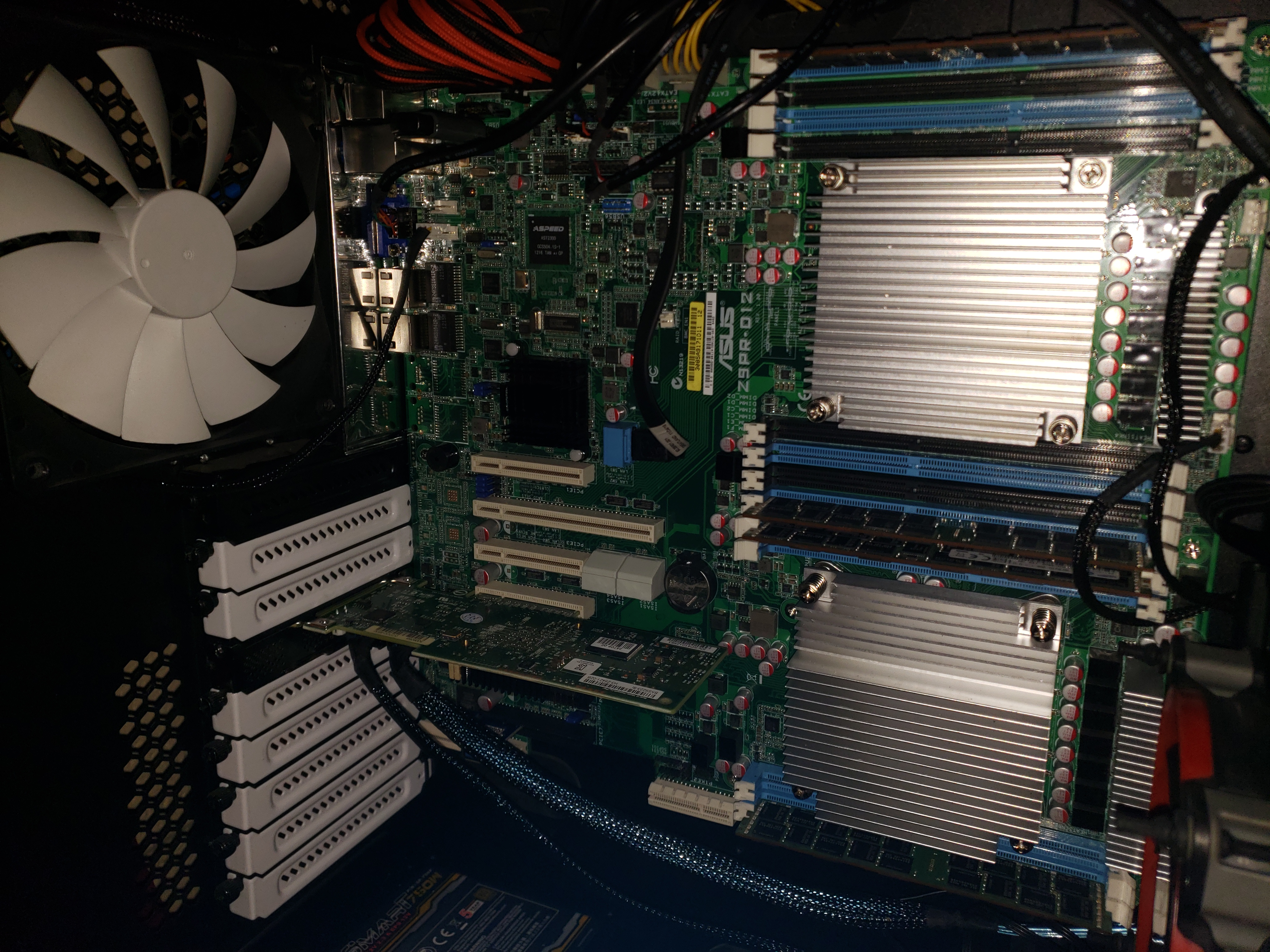

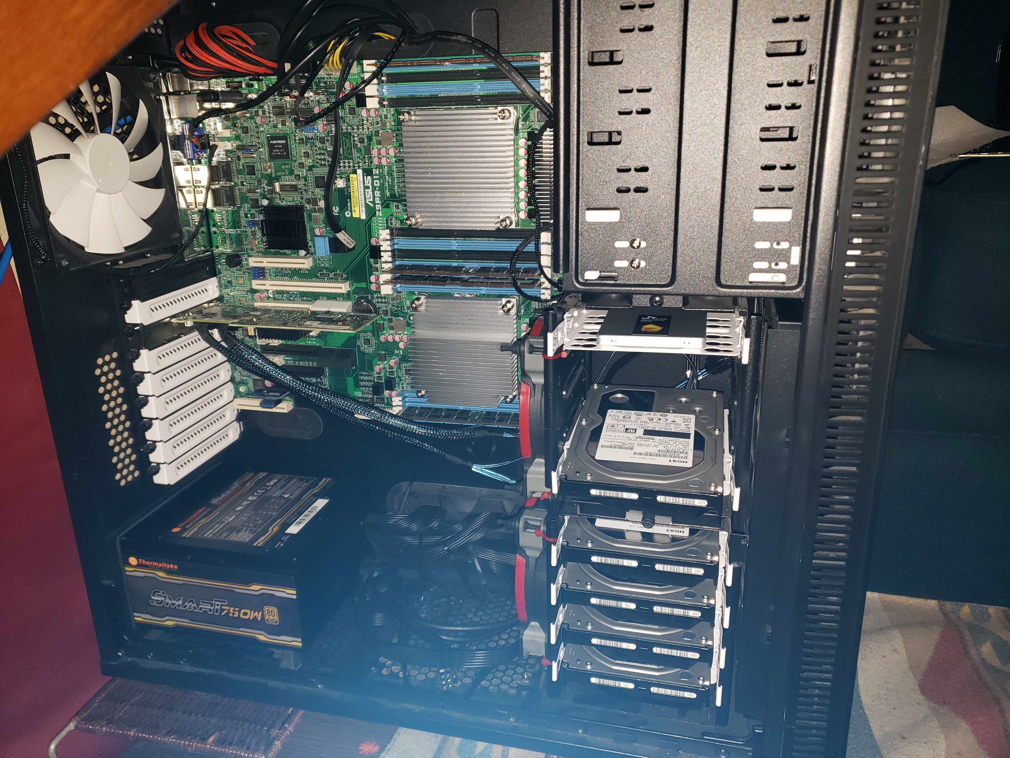

I dont think there is anything wrong with the device but just in case someone spots something...

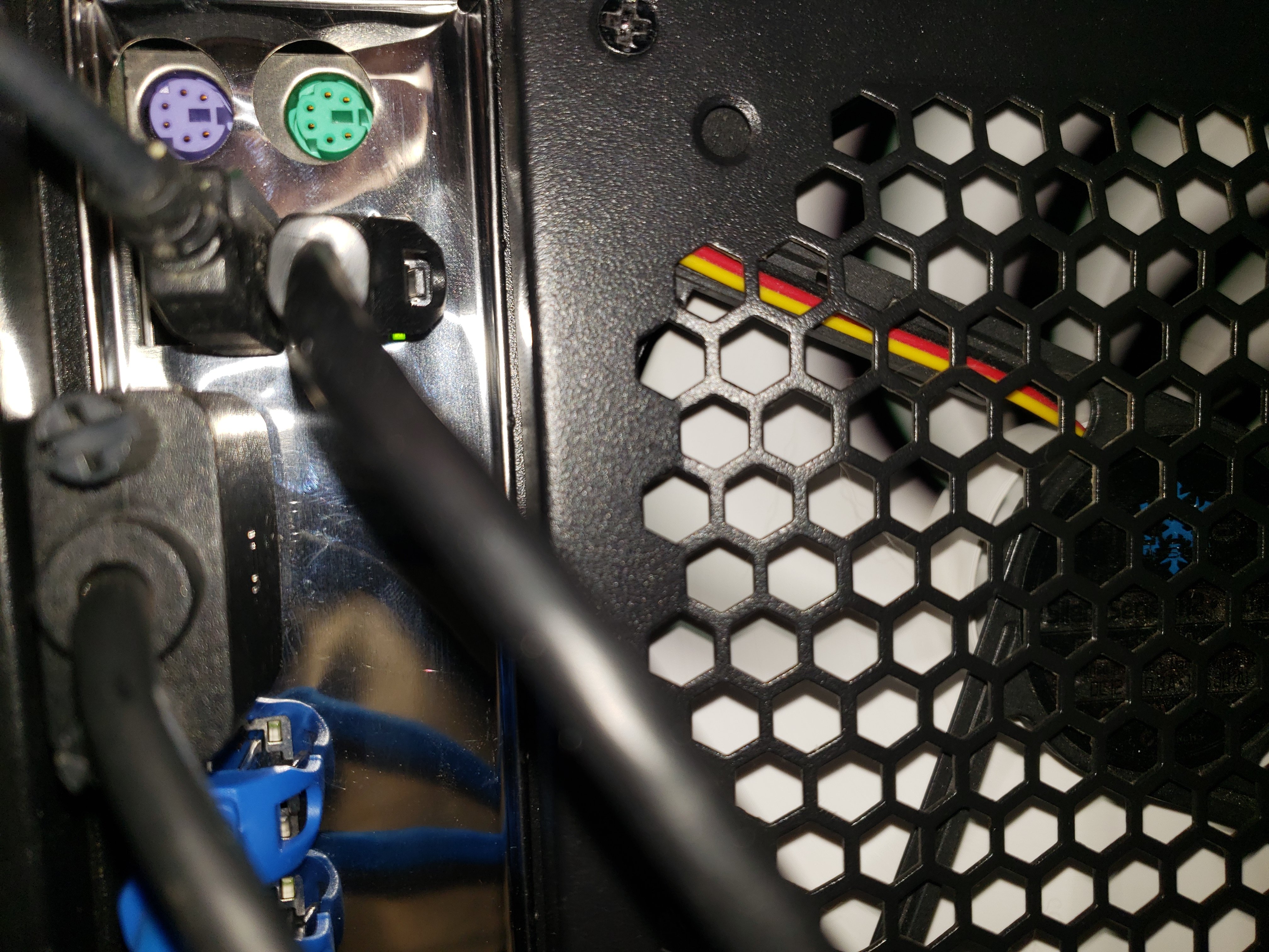

So sorry was on the phone thank you for answering. So the mobo has 3 ethernet. I plugged them all in but all I see is the Asus motherboard when I try to find it in my router gui. I followed that guide above and turned off the system, loaded it on my main pc and deleted sys network and network. Either way I can't see anything on my monitor at all or access the gui by server name or ip. It is very confounding.

Im using the onnoard vga port as I don't have a small gpu.

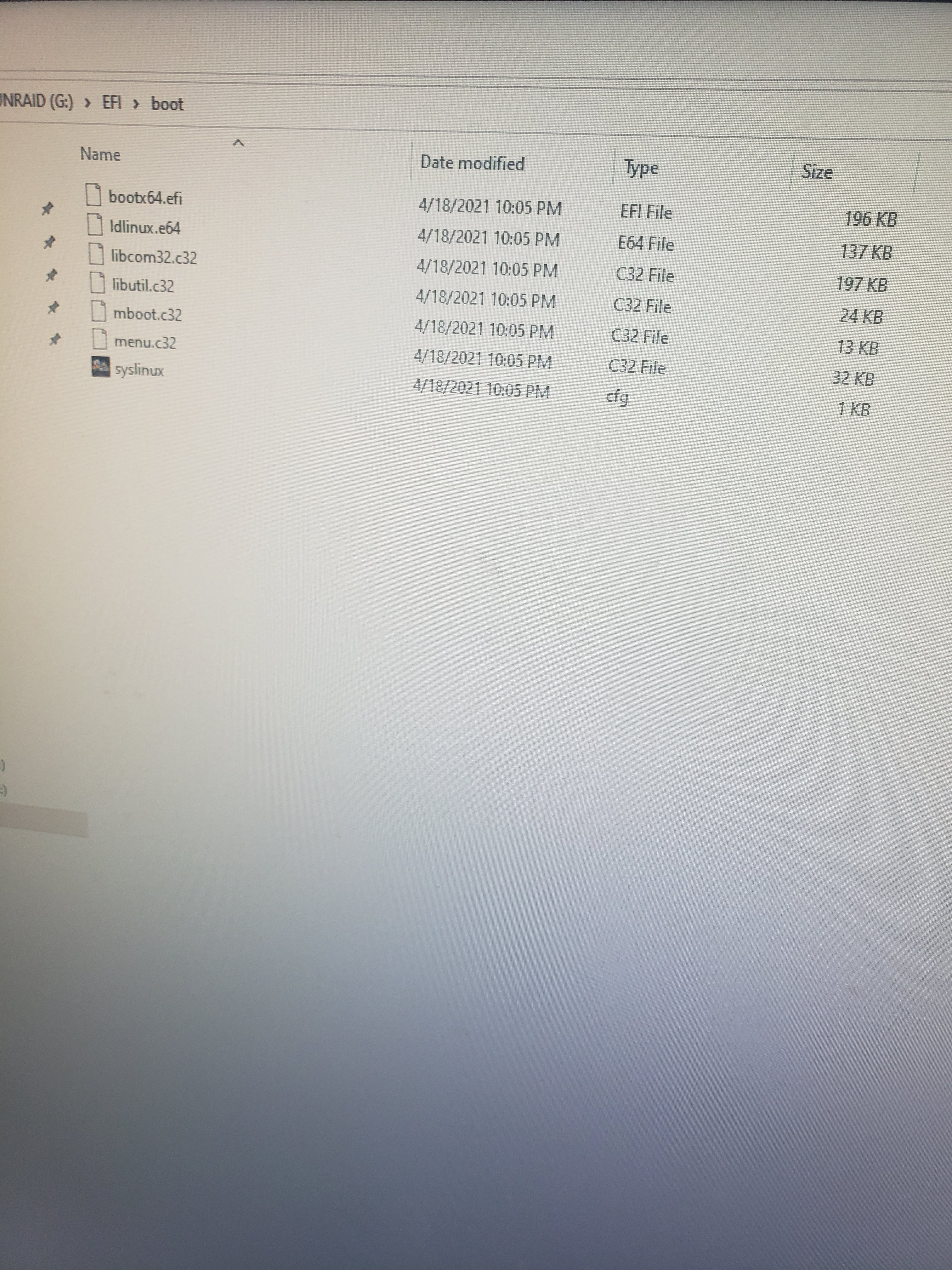

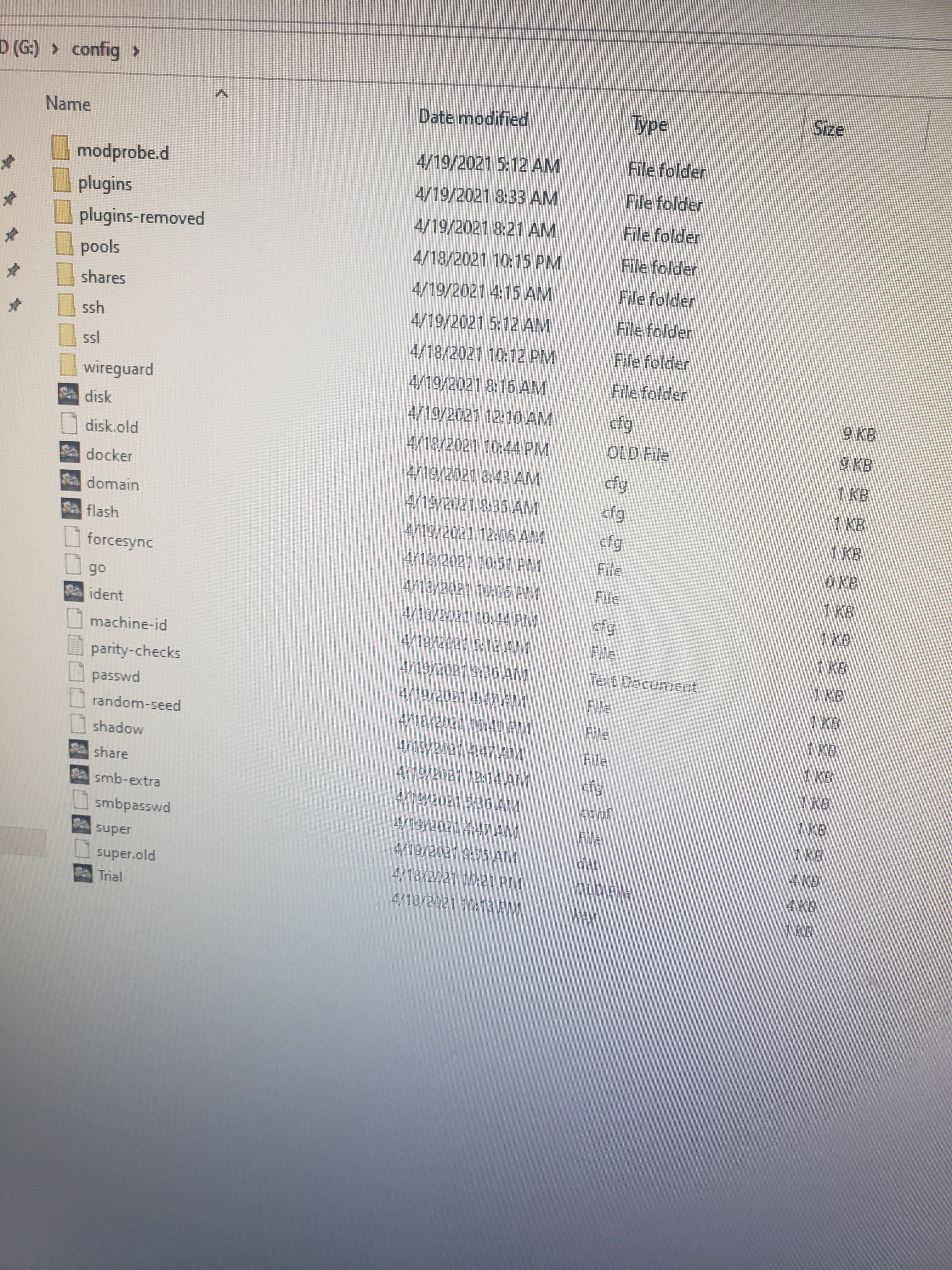

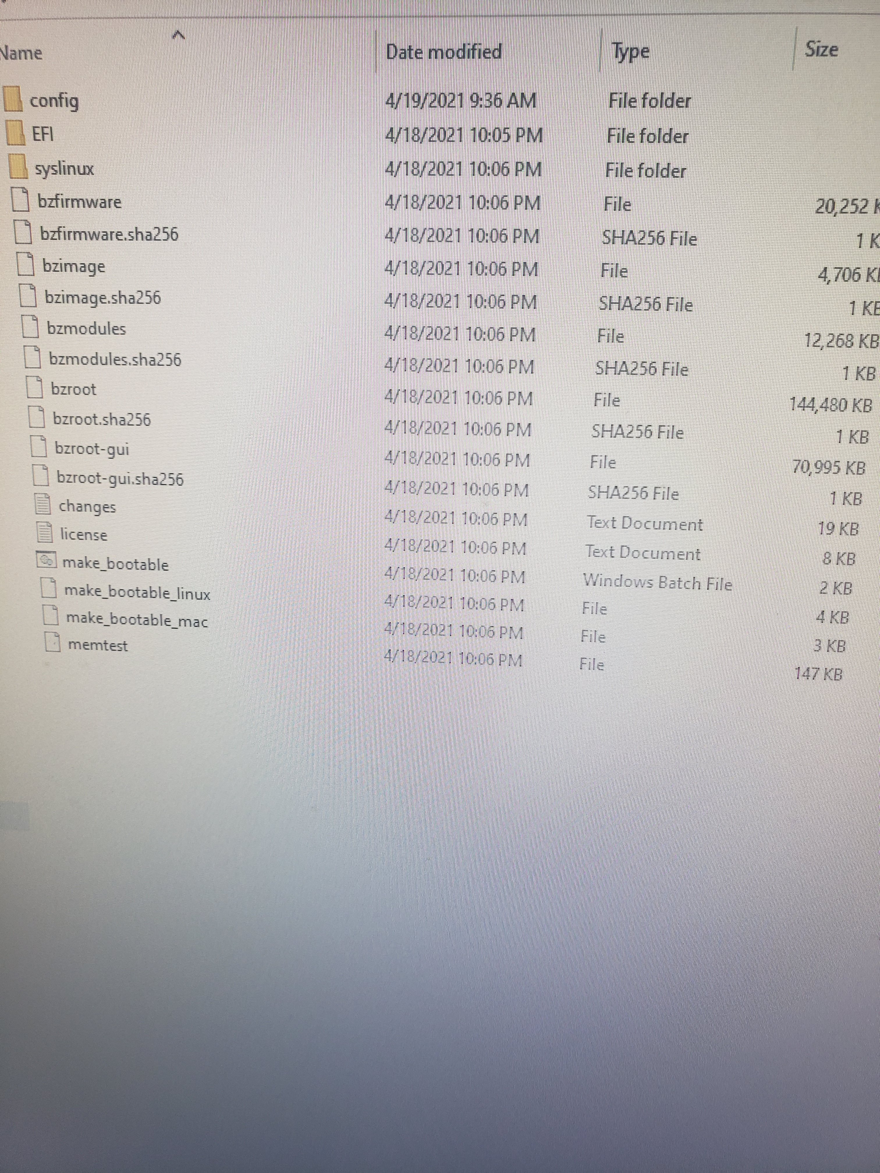

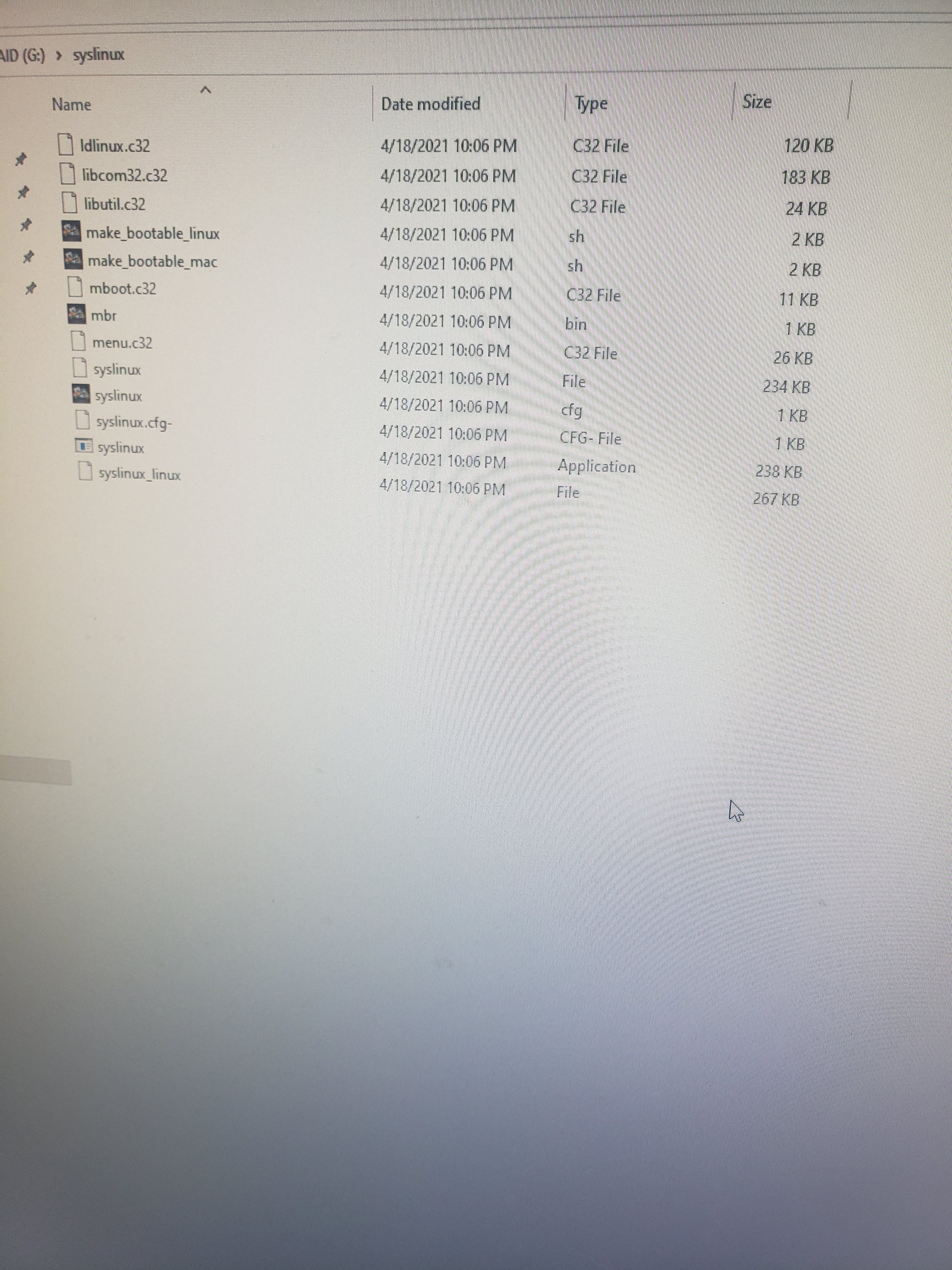

Does this help? Its the contents of the flash drive.
31 minutes ago, trurl said:
If it won't boot from the flash drive try preparing the flash drive again. Do you have a backup of flash? The config folder from your flash backup is all you need to get going again with your configuration on a new install.
I did delete the uh network and network config folders.

1 hour ago, Asteel said:
It Posted just fine this first time. It took a minute as a first time boot of the system but I could post perfectly.
Does it show the Unraid boot menu with the option to memtest, Unraid, or Unraid GUI on the attached monitor?
