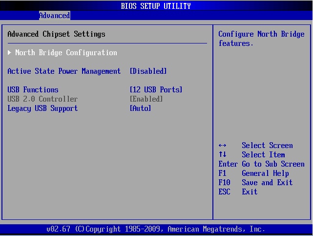

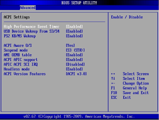

BIOS
Version is 02.67, attached the ACPI settings.
