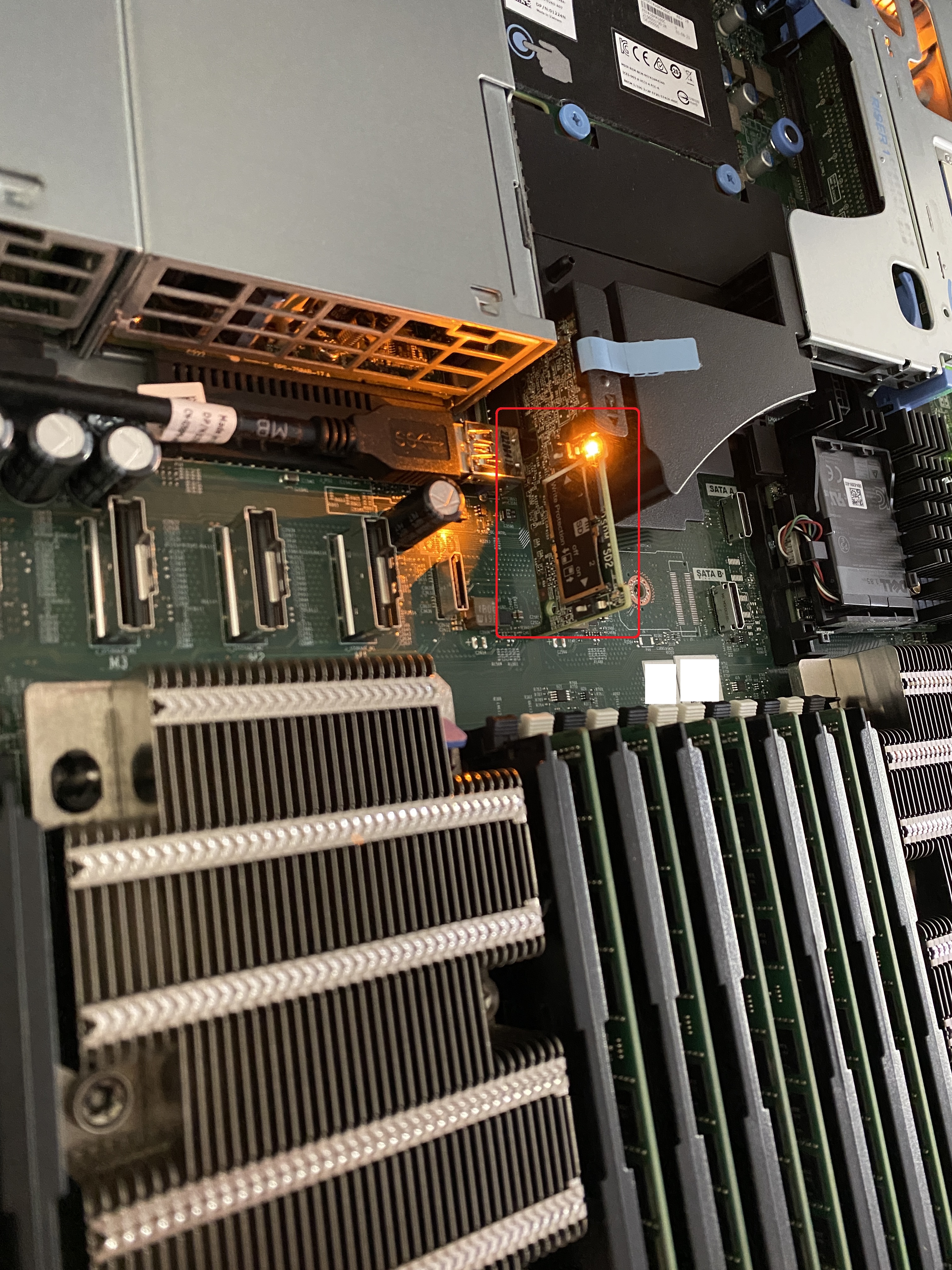

is it possible to use unraid 6 with Pro license in a Dell PowerEdge R640 with internal dual RAID1 SSD-Modul? (see screenshot)
We have no place for USB on the back (USV-Management over USB)
The front USB is not usable becase of the front cover with key?
Hope you have a solution for us.

Yes, it is a solution an i will do it, but is there no way to use the dual SD module with raid 1 setting?
A single USB-Stick as showstopper sounds possible and the solution with dual SD RAID1 is very nice.

In any case, the Unraid licence is attached to the USB drive GUID. I don't think it can load from a SD card.
Hey @ChatNoir,
i know, but an SD-Card-Slot is nothing different like a USB for the system. I tried to install an UNRAID on a USB-Stick with SD-Card slot, this works. Im not finish with this part here :) i think i have a solution to use the SD-Card modul in the server. But RAID1 will still be a dream.
I will give feedback if my idea will work, so other users with the same usecase can solve it.
Thx.

The question of being able to use the SD-Card slot is likely to depend on whether each such module has a unique GUID or whether Dell re-uses the same GUID on each such module.  Unraid would require each one to be unique.
