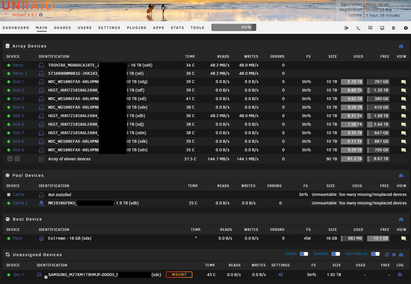

1) Share was suddenly inaccessible - i/o error encountered while transferring files over
2) Rebooted the system, and the entire cache pool and both its droves seems unaccessible
3) Rebooted again, 1 cache drive seems connected to the pool (but Unmountable: Too many missing/misplaced devices), and the other cache drive is now in "unassigned devices"
- I've try remounting the unassigned drive as read only - the files and any freshly transferred files (just before the error) seems to be intact.
- I have yet to physically touch the system - no adjustment of cables, etc throughout the process.
I've read though this https://forums.unraid.net/topic/46802-faq-for-unraid-v6/page/2/?tab=comments#comment-543490, but I'm still not very sure how I can restore things back to exactly where it was, until I take more time over the weekend. I really hope not to lose the data in the cache pool - years of maintaining my plex library, and some precious documents.
Any comments on what I should do next? Thanks so much! I've attached my current screenshot, as well as the diagnostics zip.

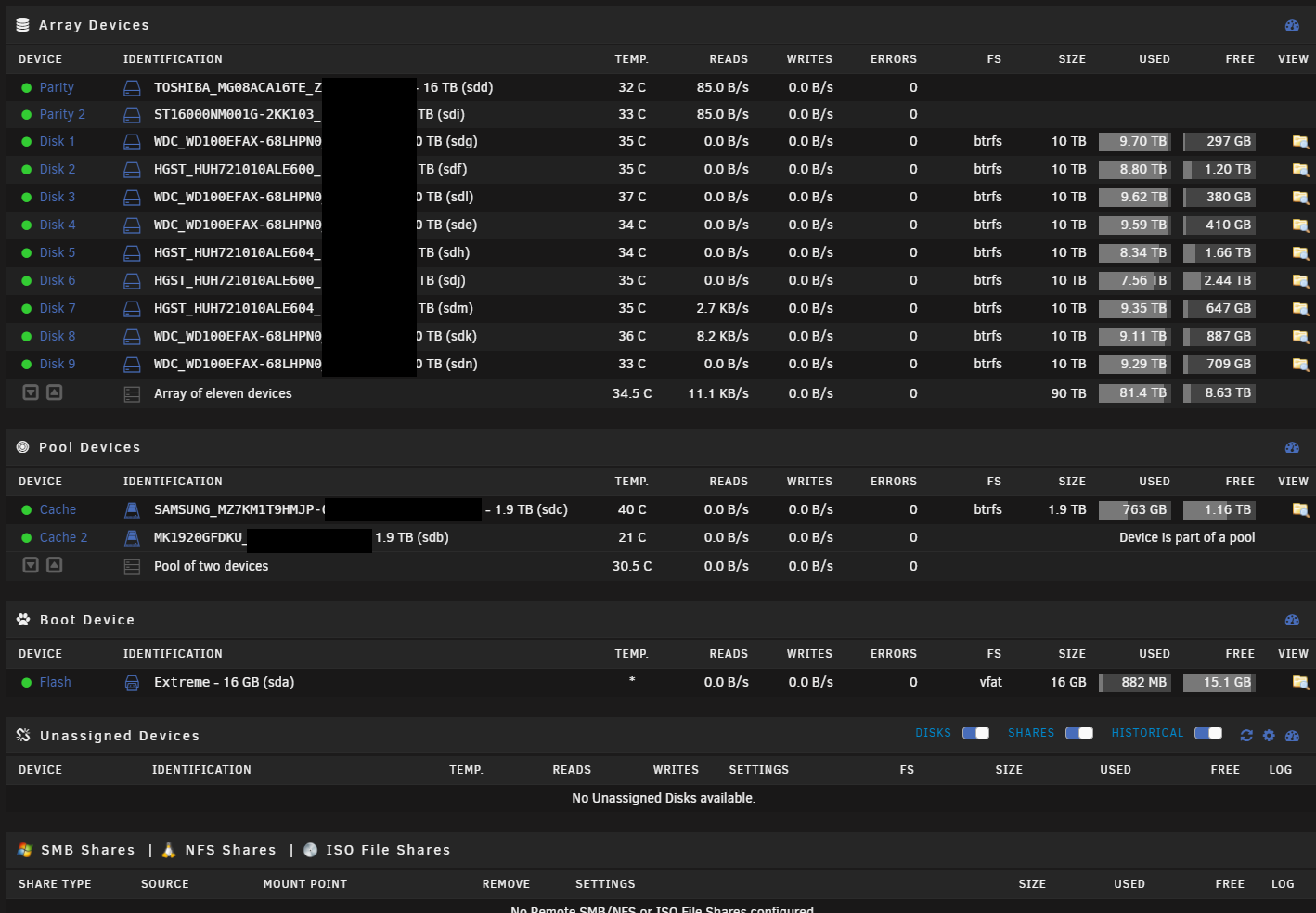

JorgeB, Tigerherz,
Thanks so much! It took me a while to figure out what it meant by "unassign all cache devices", since yesterday I was panicking and it was just a few hours before I had to take an examination 😆
It works now! I tried those steps - array down, disable dockers.
But i had to make sure to unassign all cache devices. I forgot exactly what happened, but after unassigning the remaining cache drive, the pool disappeared. I added a new pool, re-assigned the 2 drives, ensured that there was no "All existing data on this device will be OVERWRITTEN when array is Started" as mentioned, restarted array, and woohoo! All is well!
If i didn't remove and re-create a new pool, adding the drive back to the pool does give the OVERWRITTEN warning.
