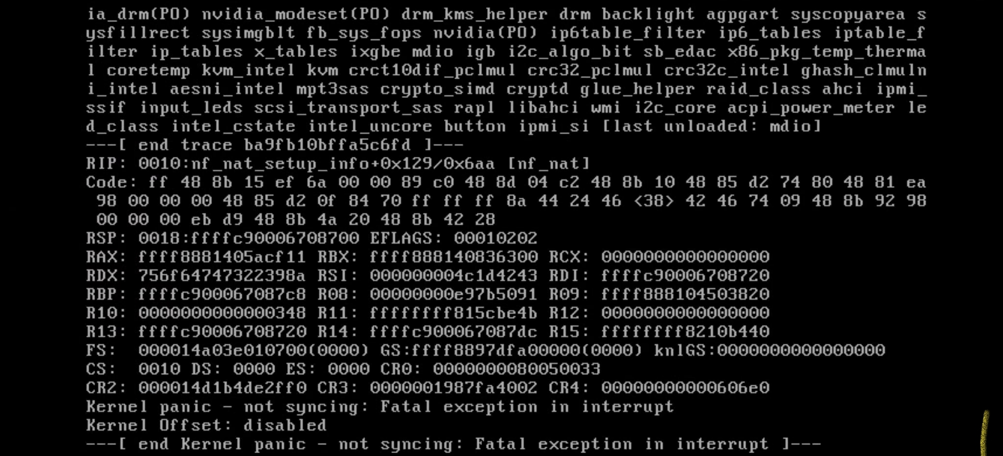

Im still getting Kernel panics, and I don't know what to check next.
Ever since upgrading to the 6.9.x versions on Unraid I have been getting Kernel panics at-least once a week, sometimes more. I have no idea what to check next to get this fixed.
So far I have; checked the RAM, and CPU, C-states are disabled in bios, temps are fine, PSU is fine. I had heard it may have been the GPU Stats plugin, so I added the below script to run on first array start;
#!/bin/bash
nvidia-persistenced
fuser -v /dev/nvidia*
I have also removed any plugins I don't actively use, and made sure the ones I do use stay updated.
The only thing I haven't tried yet is doing a BIOS update, which I would like to not do unless I completely run out of options.
Diagnostics are from after a reboot. And the below logs are from my Syslog server.

4/21/21	12:18:43	Warning	SERVERUS	kern	kernel	CR2: 0000000000000034
4/21/21	12:18:43	Warning	SERVERUS	kern	kernel	Modules linked in: md4 sha512_ssse3 sha512_generic cmac cifs libarc4 nfsv3 nfs nfs_ssc nvidia_uvm(PO) xt_CHECKSUM ipt_REJECT nf_reject_ipv4 ip6table_mangle ip6table_nat iptable_mangle nf_tables vhost_net tun vhost vhost_iotlb tap macvlan veth xt_nat xt_tcpudp xt_conntrack xt_MASQUERADE nf_conntrack_netlink nfnetlink xt_addrtype iptable_nat nf_nat nf_conntrack nf_defrag_ipv6 nf_defrag_ipv4 br_netfilter ext4 mbcache jbd2 xfs nfsd lockd grace sunrpc md_mod nvidia_drm(PO) nvidia_modeset(PO) drm_kms_helper drm backlight agpgart syscopyarea sysfillrect sysimgblt fb_sys_fops nvidia(PO) ip6table_filter ip6_tables iptable_filter ip_tables x_tables bonding e1000e igb i2c_algo_bit edac_mce_amd kvm_amd kvm crct10dif_pclmul mxm_wmi wmi_bmof crc32_pclmul crc32c_intel ghash_clmulni_intel aesni_intel crypto_simd cryptd nvme glue_helper input_leds nvme_core rapl ahci aacraid ccp i2c_piix4 led_class k10temp wmi i2c_core libahci button acpi_cpufreq [last unloaded: e1000e]
4/21/21	12:18:43	Warning	SERVERUS	kern	kernel	R13: 000014dc4a9acfe0 R14: 0000000000000010 R15: 000014dc4a7814e8
4/21/21	12:18:43	Warning	SERVERUS	kern	kernel	R10: 0000000000000000 R11: 0000000000000246 R12: 000000000000002a
4/21/21	12:18:43	Warning	SERVERUS	kern	kernel	RBP: 000014dc490e0340 R08: 0000000000000000 R09: 0000000000000000
4/21/21	12:18:43	Warning	SERVERUS	kern	kernel	RDX: 0000000000000010 RSI: 000014dc495705e0 RDI: 000000000000000e
4/21/21	12:18:43	Warning	SERVERUS	kern	kernel	RAX: ffffffffffffffda RBX: 000014dc49574b38 RCX: 000014dc4e5a4352
4/21/21	12:18:43	Warning	SERVERUS	kern	kernel	RSP: 002b:000014dc49570538 EFLAGS: 00000246 ORIG_RAX: 000000000000002a
4/21/21	12:18:43	Warning	SERVERUS	kern	kernel	Code: c3 8b 07 85 c0 75 24 49 89 fb 48 89 f0 48 89 d7 48 89 ce 4c 89 c2 4d 89 ca 4c 8b 44 24 08 4c 8b 4c 24 10 4c 89 5c 24 08 0f 05 <c3> e9 8a d2 ff ff 41 54 b8 02 00 00 00 49 89 f4 be 00 88 08 00 55
4/21/21	12:18:43	Warning	SERVERUS	kern	kernel	RIP: 0033:0x14dc4e5a4352
4/21/21	12:18:43	Warning	SERVERUS	kern	kernel	entry_SYSCALL_64_after_hwframe+0x44/0xa9
4/21/21	12:18:43	Warning	SERVERUS	kern	kernel	do_syscall_64+0x5d/0x6a
4/21/21	12:18:43	Warning	SERVERUS	kern	kernel	__x64_sys_connect+0x11/0x14
4/21/21	12:18:43	Warning	SERVERUS	kern	kernel	__sys_connect+0x62/0x9d
4/21/21	12:18:43	Warning	SERVERUS	kern	kernel	inet_stream_connect+0x34/0x49
4/21/21	12:18:43	Warning	SERVERUS	kern	kernel	__inet_stream_connect+0xd3/0x2b6
4/21/21	12:18:43	Warning	SERVERUS	kern	kernel	tcp_v4_connect+0x3fc/0x455
4/21/21	12:18:43	Warning	SERVERUS	kern	kernel	tcp_connect+0x76d/0x7f4
4/21/21	12:18:43	Warning	SERVERUS	kern	kernel	__tcp_transmit_skb+0x845/0x8ba
4/21/21	12:18:43	Warning	SERVERUS	kern	kernel	__ip_queue_xmit+0x2a3/0x2df
4/21/21	12:18:43	Warning	SERVERUS	kern	kernel	? ipv4_mtu+0x3d/0x64
4/21/21	12:18:43	Warning	SERVERUS	kern	kernel	ip_finish_output2+0x2ec/0x31f
4/21/21	12:18:43	Warning	SERVERUS	kern	kernel	__local_bh_enable_ip+0x3b/0x43
4/21/21	12:18:43	Warning	SERVERUS	kern	kernel	do_softirq+0x3a/0x44
4/21/21	12:18:43	Warning	SERVERUS	kern	kernel	do_softirq_own_stack+0x2c/0x39
4/21/21	12:18:43	Warning	SERVERUS	kern	kernel	</IRQ>
4/21/21	12:18:43	Warning	SERVERUS	kern	kernel	asm_call_irq_on_stack+0xf/0x20
4/21/21	12:18:43	Warning	SERVERUS	kern	kernel	__do_softirq+0xc4/0x1c2
4/21/21	12:18:43	Warning	SERVERUS	kern	kernel	net_rx_action+0xf4/0x29d
4/21/21	12:18:43	Warning	SERVERUS	kern	kernel	process_backlog+0xa3/0x13b
4/21/21	12:18:43	Warning	SERVERUS	kern	kernel	__netif_receive_skb_one_core+0x3d/0x95
4/21/21	12:18:43	Warning	SERVERUS	kern	kernel	__netif_receive_skb_core+0x335/0x4e7
4/21/21	12:18:43	Warning	SERVERUS	kern	kernel	? br_pass_frame_up+0xda/0xda
4/21/21	12:18:43	Warning	SERVERUS	kern	kernel	br_handle_frame+0x25e/0x2a6
4/21/21	12:18:43	Warning	SERVERUS	kern	kernel	? br_nf_forward_finish+0xd0/0xd0 [br_netfilter]
4/21/21	12:18:43	Warning	SERVERUS	kern	kernel	br_nf_pre_routing+0x229/0x239 [br_netfilter]
4/21/21	12:18:43	Warning	SERVERUS	kern	kernel	NF_HOOK+0xd7/0xf7 [br_netfilter]
4/21/21	12:18:43	Warning	SERVERUS	kern	kernel	? br_handle_frame_finish+0x351/0x351
4/21/21	12:18:43	Warning	SERVERUS	kern	kernel	? nf_nat_ipv4_pre_routing+0x1e/0x4a [nf_nat]
4/21/21	12:18:43	Warning	SERVERUS	kern	kernel	br_nf_pre_routing_finish+0x23d/0x264 [br_netfilter]
4/21/21	12:18:43	Warning	SERVERUS	kern	kernel	br_nf_hook_thresh+0xa3/0xc3 [br_netfilter]
4/21/21	12:18:43	Warning	SERVERUS	kern	kernel	? ipt_do_table+0x570/0x5c0 [ip_tables]
4/21/21	12:18:43	Warning	SERVERUS	kern	kernel	br_handle_frame_finish+0x30d/0x351
4/21/21	12:18:43	Warning	SERVERUS	kern	kernel	netif_receive_skb+0x79/0xa1
4/21/21	12:18:43	Warning	SERVERUS	kern	kernel	__netif_receive_skb_one_core+0x74/0x95
4/21/21	12:18:43	Warning	SERVERUS	kern	kernel	ip_rcv+0x41/0x61
4/21/21	12:18:43	Warning	SERVERUS	kern	kernel	? l3mdev_l3_rcv.constprop.0+0x50/0x50
4/21/21	12:18:43	Warning	SERVERUS	kern	kernel	nf_hook.constprop.0+0xb1/0xd8
4/21/21	12:18:43	Warning	SERVERUS	kern	kernel	nf_hook_slow+0x39/0x8e
4/21/21	12:18:43	Warning	SERVERUS	kern	kernel	ip_sabotage_in+0x43/0x4d [br_netfilter]
4/21/21	12:18:43	Warning	SERVERUS	kern	kernel	? ip_check_defrag+0x18f/0x18f
4/21/21	12:18:43	Warning	SERVERUS	kern	kernel	ip_forward+0x3f1/0x420
4/21/21	12:18:43	Warning	SERVERUS	kern	kernel	? __ip_finish_output+0x146/0x146
4/21/21	12:18:43	Warning	SERVERUS	kern	kernel	ip_output+0x7d/0x8a
4/21/21	12:18:43	Warning	SERVERUS	kern	kernel	nf_hook+0xab/0xd3
4/21/21	12:18:43	Warning	SERVERUS	kern	kernel	nf_nat_ipv4_out+0xf/0x88 [nf_nat]
4/21/21	12:18:43	Warning	SERVERUS	kern	kernel	nf_nat_inet_fn+0xe9/0x183 [nf_nat]
4/21/21	12:18:43	Warning	SERVERUS	kern	kernel	? fib_validate_source+0xb0/0xda
4/21/21	12:18:43	Warning	SERVERUS	kern	kernel	? __dev_queue_xmit+0x4d9/0x501
4/21/21	12:18:43	Warning	SERVERUS	kern	kernel	ipt_do_table+0x51a/0x5c0 [ip_tables]
4/21/21	12:18:43	Warning	SERVERUS	kern	kernel	? netdev_start_xmit+0x1b/0x38
4/21/21	12:18:43	Warning	SERVERUS	kern	kernel	masquerade_tg+0x44/0x5e [xt_MASQUERADE]
4/21/21	12:18:43	Warning	SERVERUS	kern	kernel	nf_nat_masquerade_ipv4+0x10b/0x131 [nf_nat]
4/21/21	12:18:43	Warning	SERVERUS	kern	kernel	? krealloc+0x26/0x7a
4/21/21	12:18:43	Warning	SERVERUS	kern	kernel	? __ksize+0x15/0x64
4/21/21	12:18:43	Warning	SERVERUS	kern	kernel	? sch_direct_xmit+0x16/0x1de
4/21/21	12:18:43	Warning	SERVERUS	kern	kernel	<IRQ>
4/21/21	12:18:43	Warning	SERVERUS	kern	kernel	Call Trace:
4/21/21	12:18:43	Warning	SERVERUS	kern	kernel	CR2: 0000000000000034 CR3: 0000000216e82000 CR4: 00000000003506f0
4/21/21	12:18:43	Warning	SERVERUS	kern	kernel	CS:  0010 DS: 0000 ES: 0000 CR0: 0000000080050033
4/21/21	12:18:43	Warning	SERVERUS	kern	kernel	FS:  000014dc49574b38(0000) GS:ffff8887fe800000(0000) knlGS:0000000000000000
4/21/21	12:18:43	Warning	SERVERUS	kern	kernel	R13: ffffc90000003720 R14: ffffc900000037dc R15: ffffffff8210b440
4/21/21	12:18:43	Warning	SERVERUS	kern	kernel	R10: ffff88821d56c388 R11: ffffffff815cbe4b R12: 0000000000000000
4/21/21	12:18:43	Warning	SERVERUS	kern	kernel	RBP: ffffc900000037c8 R08: 00000000d638ba09 R09: ffff88818fa62b80
4/21/21	12:18:43	Warning	SERVERUS	kern	kernel	RDX: ffffffffffffffee RSI: 000000007418f38d RDI: ffffc90000003720
4/21/21	12:18:43	Warning	SERVERUS	kern	kernel	RAX: ffff88819ec50206 RBX: ffff88816107f0c0 RCX: 0000000000000000
4/21/21	12:18:43	Warning	SERVERUS	kern	kernel	RSP: 0018:ffffc90000003700 EFLAGS: 00010286
4/21/21	12:18:43	Warning	SERVERUS	kern	kernel	Code: ff 48 8b 15 ef 6a 00 00 89 c0 48 8d 04 c2 48 8b 10 48 85 d2 74 80 48 81 ea 98 00 00 00 48 85 d2 0f 84 70 ff ff ff 8a 44 24 46 <38> 42 46 74 09 48 8b 92 98 00 00 00 eb d9 48 8b 4a 20 48 8b 42 28
4/21/21	12:18:43	Warning	SERVERUS	kern	kernel	RIP: 0010:nf_nat_setup_info+0x129/0x6aa [nf_nat]
4/21/21	12:18:43	Warning	SERVERUS	kern	kernel	Hardware name: System manufacturer System Product Name/ROG STRIX B450-F GAMING, BIOS 2301 04/19/2019
4/21/21	12:18:43	Warning	SERVERUS	kern	kernel	CPU: 0 PID: 13620 Comm: python3 Tainted: P        W  O      5.10.28-Unraid #1
4/21/21	12:18:43	Warning	SERVERUS	kern	kernel	Oops: 0000 [#1] SMP NOPTI
4/21/21	12:18:43	Information	SERVERUS	kern	kernel	PGD 0 P4D 0
4/21/21	12:18:43	Alert	SERVERUS	kern	kernel	#PF: error_code(0x0000) - not-present page
4/21/21	12:18:43	Alert	SERVERUS	kern	kernel	#PF: supervisor read access in kernel mode
4/21/21	12:18:43	Alert	SERVERUS	kern	kernel	BUG: kernel NULL pointer dereference, address: 0000000000000034

I'm in the same boat but I have a powerege r720. Been getting a kernel panic at least once a day for the past 2 or 3 weeks. Memtest clean, syslog shows nothing. I've tried every trick I've found in this forum and others... I have no idea what to do next except downgrade. It's getting terribly frustrating.
Ok so I finally got a chance to rerun the memtest, and I did get a few errors on the first run. I shutdown and reseated the DIMMS and it passed just fine. Maybe something got knocked loose at some point.
I also updated my motherboard to the latest bios. Unfortunately, ever since updating the bios UNRAID doesn’t see any of the disks attached to my Adaptec HBA, and I am not seeing it’s bios on boot either.
In my motherboards bios I made sure quick boot was disabled, show logo is disabled, show oprom enabled, and allow interrupt 19 is enabled...now the panic starts to set in...
EDIT: That was a great use of almost 4 hours, the raid card not showing up was due to a new BIOS option in the update that ASUS didn’t bother to document...
Back to the original issue. RAM good, bios is updated, I’m going to continue monitoring and see what happens this week. I really hope I can get some stability back, things have been rough since 6.9
Edited by relink
