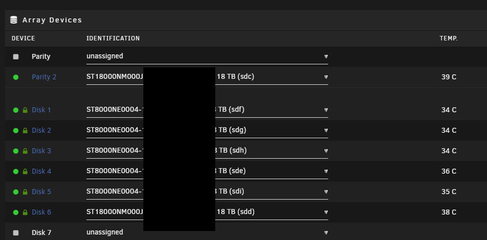

I run Unraid 6.9.2 and I don't know if there's something I'm doing here.. But I added a new drive into my Unraid server, and when I reboot the server, it shows up correctly. However, in my flash, it does not show the correct disk assignments in the DISK_ASSIGNMENTS text file.
Show in my attached files you can see the disk_assignments file straight from the flash today, and on the picture how my setup looks.
The last "write" to the file is the 11/04/2021, even though I just added a new disk yesterday, and removed a cache pool
What am I getting wrong here? :)

Disk assignments is created by the Appdata backup plugin, and is valid at the point the backup is made.
Thanks a lot Squid, I just did a manual backup, and it is not correct! Have a lovely evening
Then USB backup portion of the plugin isn't enabled.  No biggie.  If you use unraid.net to keep backups, the super.dat file is included in it
