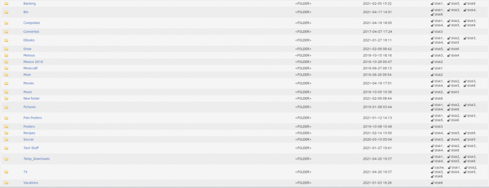

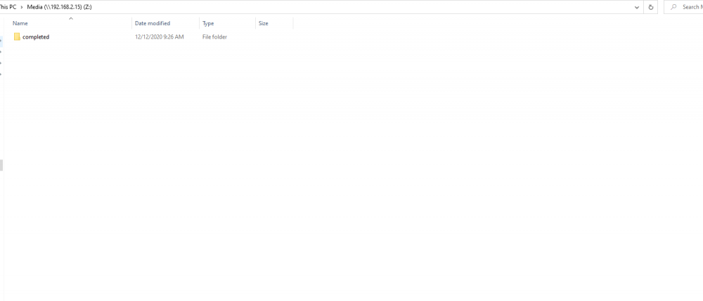

About a month ago, i noticed that when i goto //tower/media i can only see one folder (which is empty and it shouldn't be). When i go to my unraid i should see a number of folders.

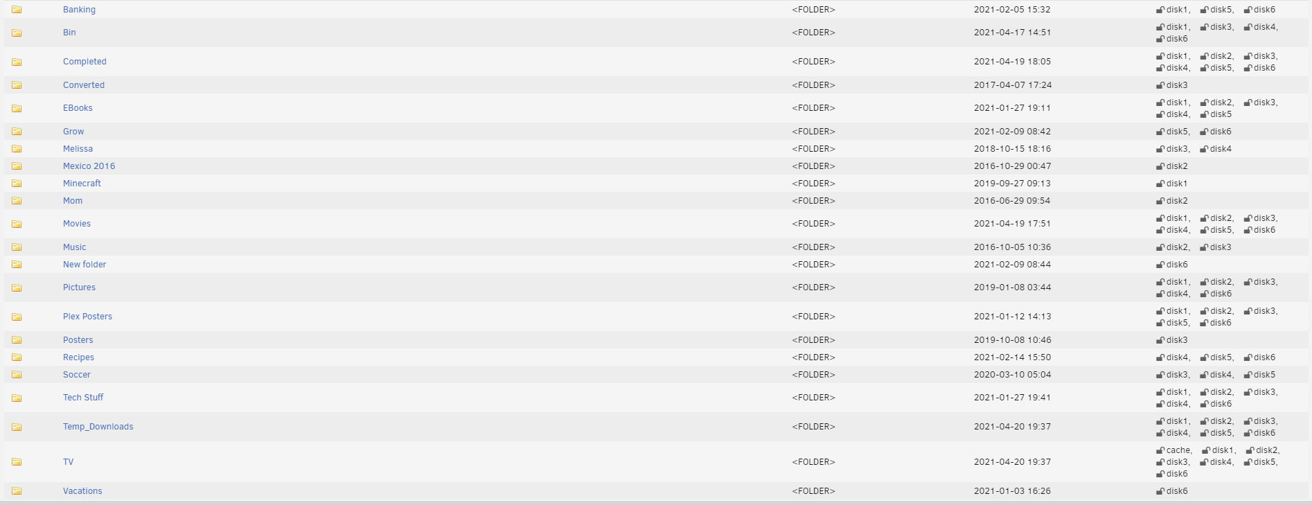

When i go into shares in unraid i can see everything fine .

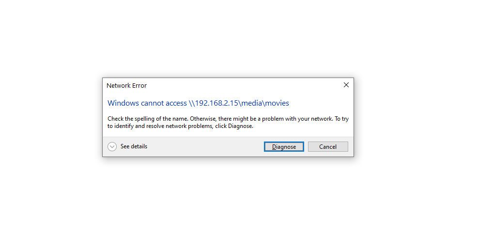

That will cause problems as Linux is case sensitive and Samba (SMB) is not.   In such a case you will find that one of those folders appears under the share contents and the other will not.
It's basically a Windows problem because it does not support a share named "Media" and one named "media" at the same time.  But since Unraid actually does, when exporting over a network it has to pick one or the other otherwise very strange things happen in Windows when accessing it.
What you need to do is copy all those files from the one that's exported ("media") somewhere else (your desktop), then delete the share, then copy all the files back into the share that now will appear.
