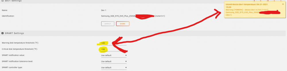

I have a NVMe that I've set to warn at 140F but continue to get the 'Yellow Warning' that drive is hot (115F).  How can I get this warning to respect drive settings?  Is this a bug in 6.9.1?

Ok...when I went back to update/change the numbers (changing them on the line and clicking 'Apply') - it doesn't seem to 'take' - they revert back to the original numbers after the 'Apply' is pressed and screen refreshes!  BUT looking at the file from the CLI shows the correct info in the file.  I guess it is just waiting for a reboot to show on the screen?
And such a weird thing....my 'Cache' drives are showing the temps in 'F' (which is what my system default is) but the 'Dev 1' drive (which is part of 'Unassigned Drives') is showing its information in Celsius?  (the correct information with my updated temps - but still different format)....I'm thinking that might be the issue?
Thanks again - dave
OH....and another weird issue.....my Cache drive entries include their names....while the assigned drive entry does not?  Here is my new file:

welp....I figured that 'time would tell' if those changes were successful.....the answer is no.
Just received the 'Yellow Warning' with the 115F temp (whereas the actual file shows correct/higher temp) and it is ignoring it.
Is it an 'Unassigned Devices' issue?  (UPDATE:  Nope....as it just happened to my other NVMe drive - yellow warning @ 115 and not the set temp)
