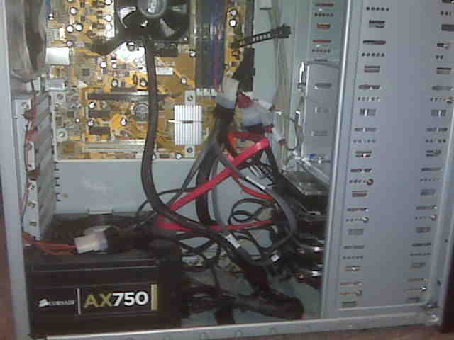

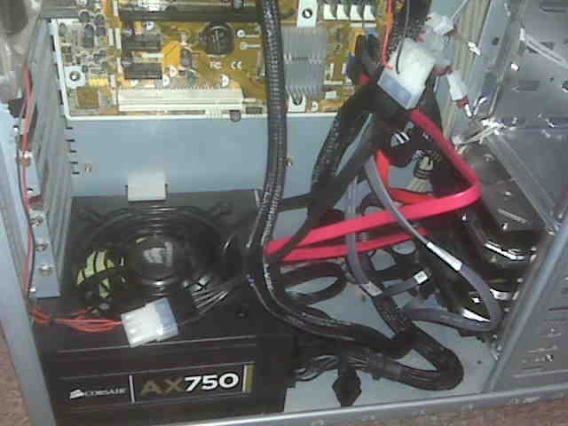

Update Feb 27, 2011 - Another late night. Decided to start on the initial build even though I do not have all the parts yet or drives freed up. Can at least start testing and get some pics done. All in all coming together nice. Maybe soon I will actually test and see if it boots up.  :P
Issue #1 - Cable management. The draw back to the lower cost of the CM cages versus say an IcyDock or SuperMicro, cable management a lot harder.
Issue #2 - Space. Not a lot of clearance in the Antec 900 between back of the drives and the mobo. A 1200 would probably have more room. I have a HAF 932 and a HAF X as well, both of which have a lot more clearances, but they are custom builds I am not tearing apart. :)

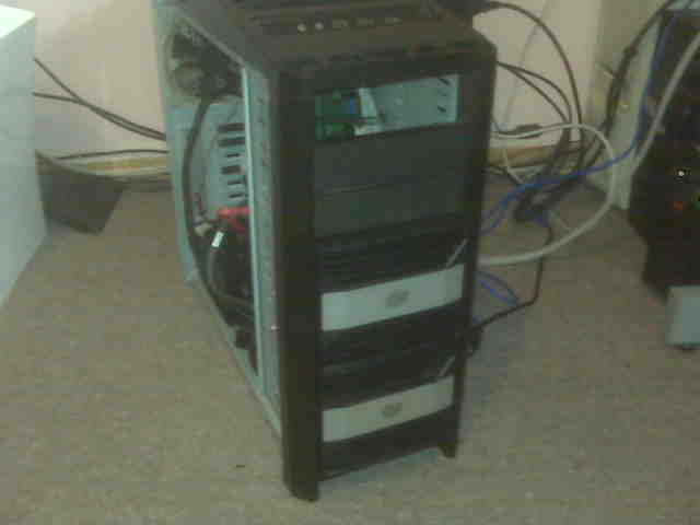

Update March 2nd - Have the system powered up, three drives in it. All is running fine - version 5 beta 5b... I think... they changing a lot. :)  Still waiting for the controllers from Newegg - cross border shipping... <sigh>
Update March 6th - Well I have been busy. :) Please see post here... http://lime-technology.com/forum/index.php?topic=11530.0
Got the two controllers and working away on things. Preclearing drives, formating, oh the joys of unRaid. :) One thing I have noticed, although these CM cages are not hot swap, the 120mm fan on front really works well keeping the drives cool. In all my testing I have not seen any drive go about 30C. Typically they run about 23-25C. Guess a trade off on convenience for superior cooling... and silence. They are super quiet.
