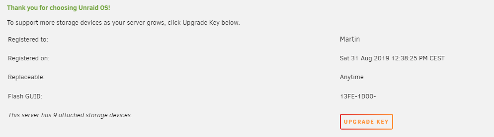

old usb drive includes a Plus.key in the config folder but i thought its hardware bound to the GUID of the usb drive ?

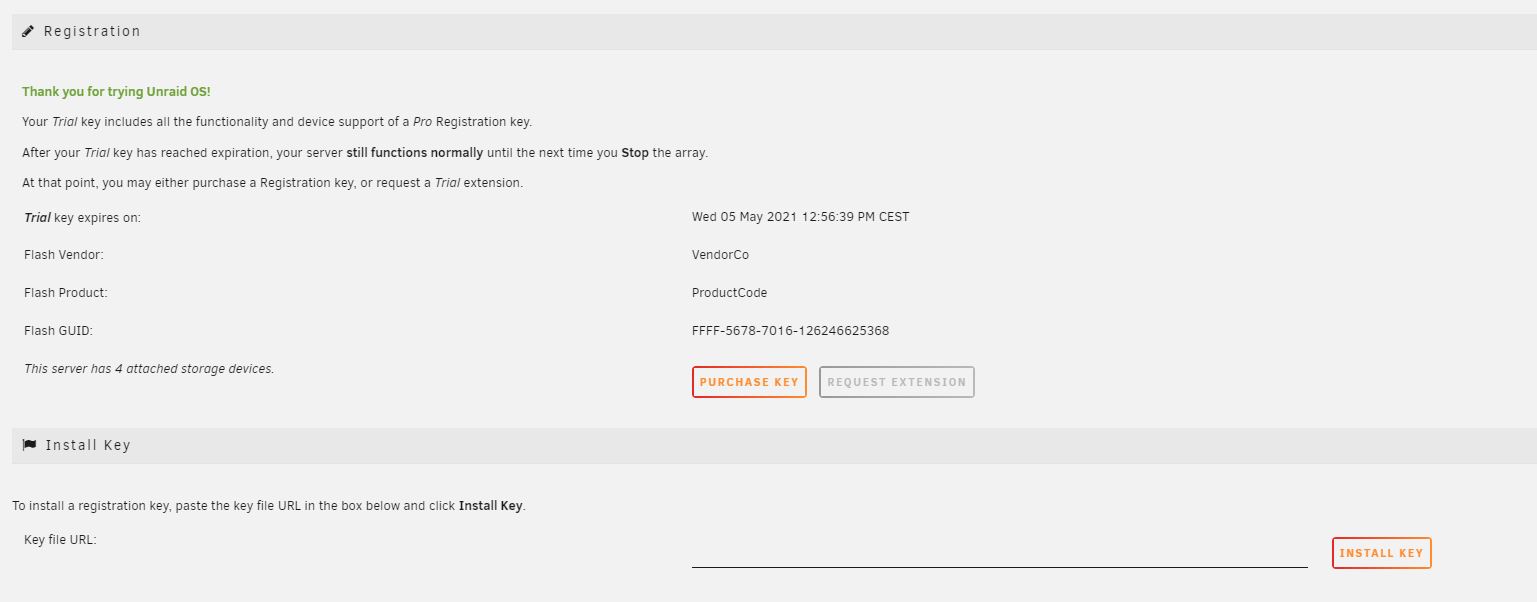

isn´t there a "correct" procedure to simply move my licence to a new usb drive ? it says install key here but from my understanding (and the purchase email) its bound to the Flash GUID: 13FE-1D00 .. how do i bind it to the new usb drive ?

yes - but i had no "Replace Key" button while on Trial.
if anybody comes to this for a solution:
on the new server : go to "Tools" -> Registration. Supply the "wrong" key file (you got a link per mail when you purchased it, or take the key file from your old usb), it will register that its the wrong key:
The registered GUID does not match the USB Flash boot device GUID
The Registration key file does not correspond to the USB Flash boot device. Please copy the correct key file to the config directory on your USB Flash boot device. If you do not have a backup copy of your key file, Contact Support.
after that you have the replace key option and can follow the solution above. thanks for the help guys - got the new key mail within seconds and could install it without a problem.
