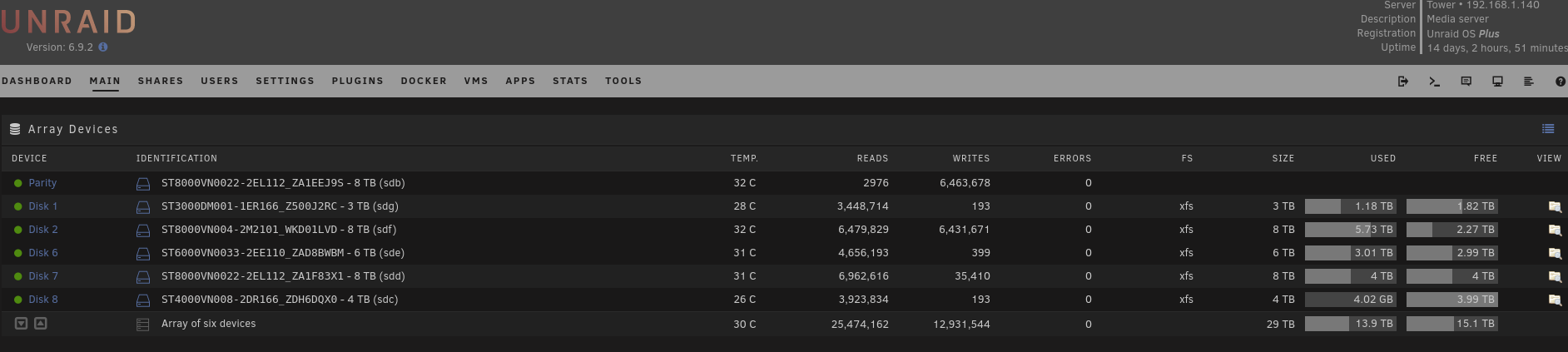

I recently started getting a warning on the size of one of the disks that it was around 75% full.
The main screen bears that out.
That's ok - but I have a disk with 4Tb that hasn't even been touched - it remains empty.

In any case, what you have seems like the expected Highwater allocation. When that disk gets past 75% I would expect it to reevaluate and choose disk7 (or maybe disk8) for a while.
Disk2 was 72% in those diagnostics so maybe you moved some files off it yourself.

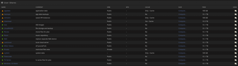

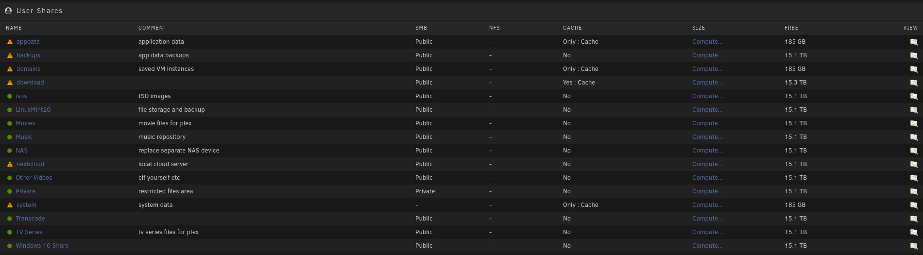

This is a pick of the shares currently. As expected.
I checked out the contents of each one and they are as expected with the shares that are below.

Oh forgot to add the highwater mark is 70% on disk 2.
Does that trigger changes in unraid that cause the system to change where the files are stored?
